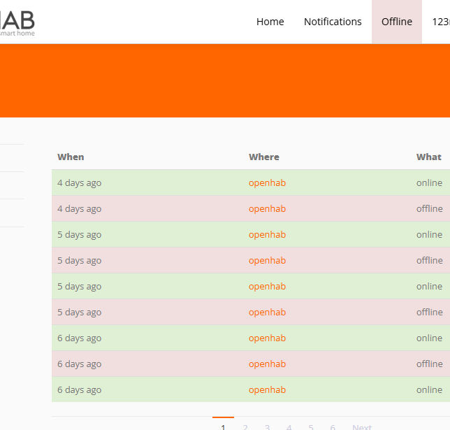

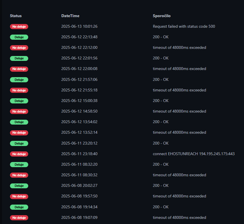

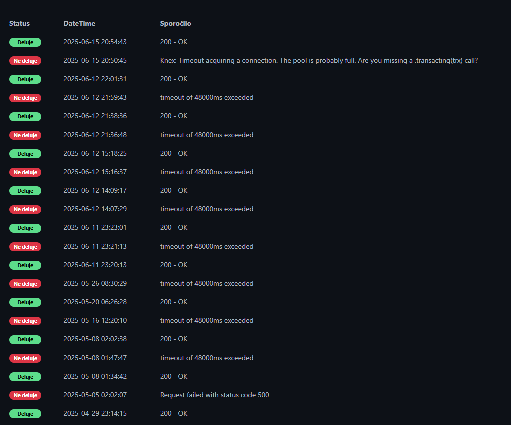

Hi i run Uptime kuma for some time now and i monitor 2 instances of openhab locally and over the cloud.
Both locally run 99%+ of time, tho one is in remote cabin.
But i see that the cloud connection is droping, ok, but it takes long time to get back online, why is that?

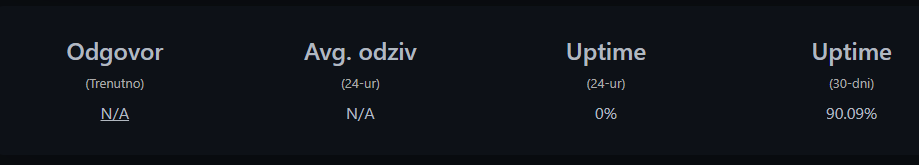

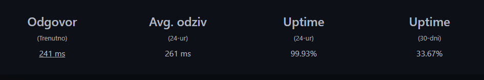

So here is the first OH 2.5 at home on fiber optic that has 99.99% uptime, OH instance cloud connection has 33% uptime in 30 days, that to some cause may interfere as is an older OH version.
But why also OH the remote OH 4.2.0 has only 90% uptime, while it is on 4G, the modem has some 98% uptime usually. In other words my notifications arent workin and whenever i check it, the dang thing is offline.

Sorry what are these graphs actually monitoring ? Is this a http check and if so to what URL exactly? How often is it checking?
Also posting DEBUG logs from the cloud connector addon would be helpful to understand if its going up and down.
Hi
I monitor this URL every 60s, with user and password of course.
https://home.myopenhab.org/basicui/app?sitemap=openhab_doma
The first check on OH cloud confirms that going up n down, i may be able to grab logs later, for start i snipped this
