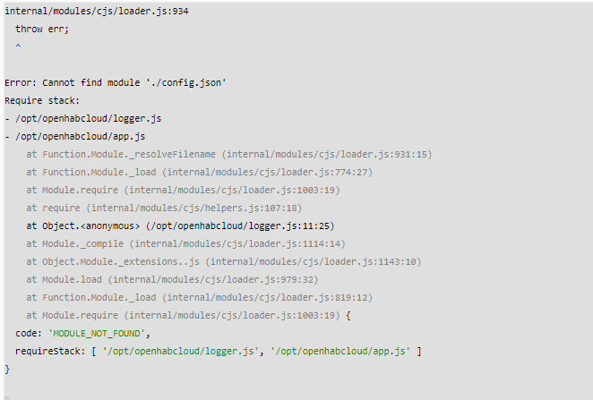

Could you please help me resolving this:

What is this installation based on ? You did it yourself ?
During setup of the openhab cloud you need to create the config.json file. It is not part of the installation.

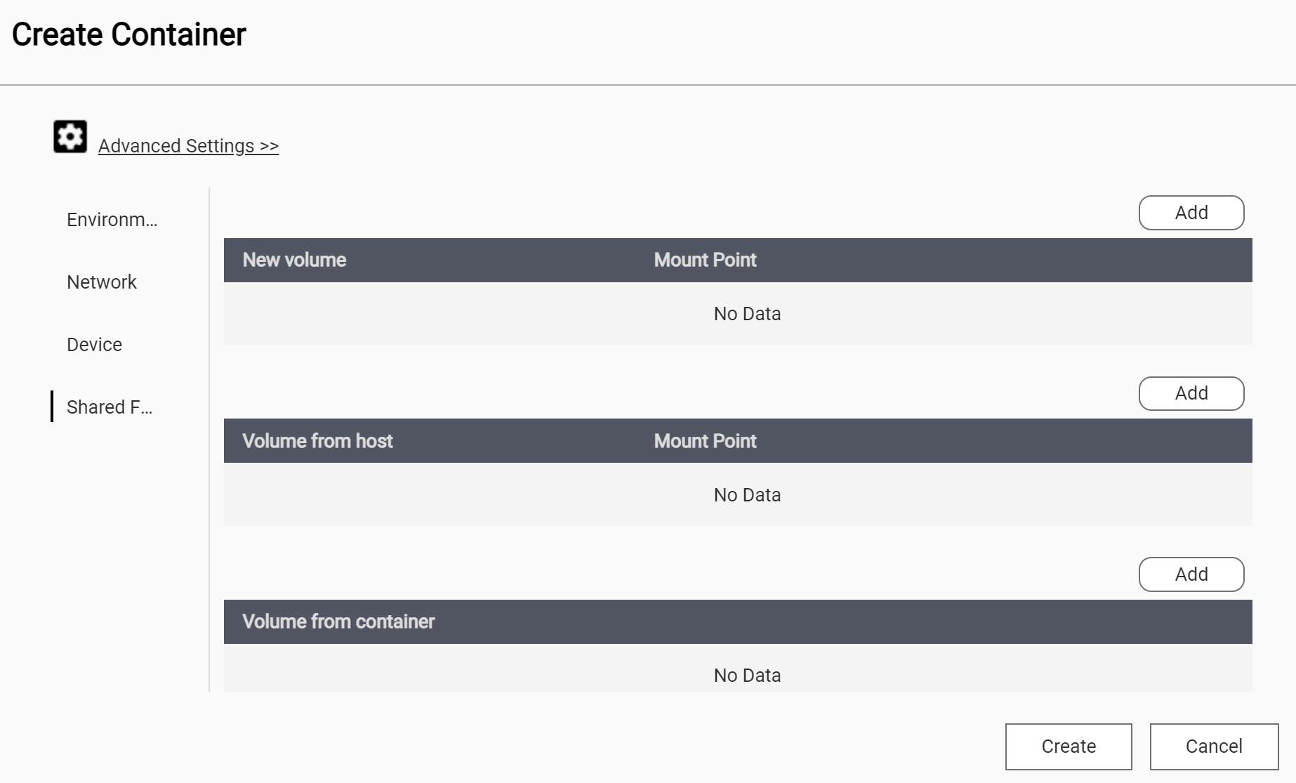

I think the problem is that this docker container don’t ask for shared folders where I can place this config file. Could you add them?

the YAML file as shown in openhab-cloud/deployment/docker-compose/docker-compose.yml at main · openhab/openhab-cloud · GitHub uses volumes in the configuration that means the configuration file is placed on the host system and used within the guest system.
I don’t use a docker installation for openhab-cloud instance. Could you check if the config.json.template is available on your system - it must as that one contains your configuration.

Ok I’ll search that volume in the file system. In the creation there is no volume asked as normaly:

No it’s not on my system. Perhaps because of the missing volume?
