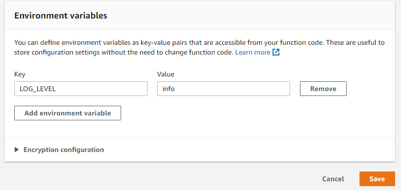

You can also checked the Lambda function logs, by setting the environment variable LOG_LEVEL = info on that function, to see what the skill is doing when you are making discovery requests.

Will check how to enable Log_level = Info and check it out
Thanks :slight_smile:
The only guide to follow in order to properly deploy the latest Alexa skill is the official one. Any previous guides, unless updated recently, should be discarded. Hopefully, you cleaned up your environment after following the outdated guidelines.
Stupid question… from where does one enable to Log_level=Info ?

answered my own

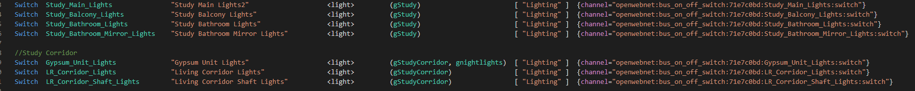

i have removed all my items, just in case any one of them is stopping the alexa scan to pick them up and only left the 3 below (with experimental tags)
Switch	Study_Main_Lights		"Study"		<light>		(gStudy)	[ "LightSwitch" ]	{channel="openwebnet:bus_on_off_switch:71e7c0bd:Study_Main_Lights:switch"}
Switch	Study_Balcony_Lights	"Balcony"	<light>		(gStudy)	[ "Switchable" ]	{channel="openwebnet:bus_on_off_switch:71e7c0bd:Study_Balcony_Lights:switch"}
Switch	Study_Bathroom_Lights	"Bathroom"	<switch>	(gStudy)	[ "Lighting" ]		{channel="openwebnet:bus_on_off_switch:71e7c0bd:Study_Bathroom_Lights:switch"}

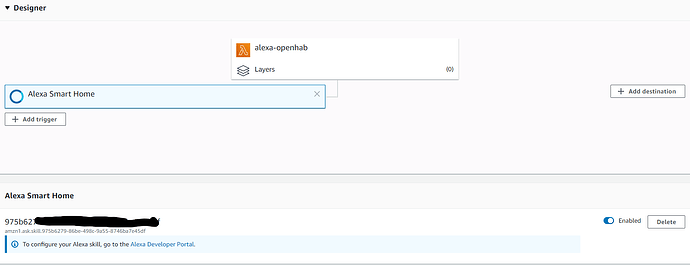

Can you see discovery requests coming in your Lambda function from the skill?
Not sure how to check that, but as soon as I run a discovery, my web server is not being hit. No logs on firewall and/or web server
When I run a lambda discovery test I can see the request and packets come in.

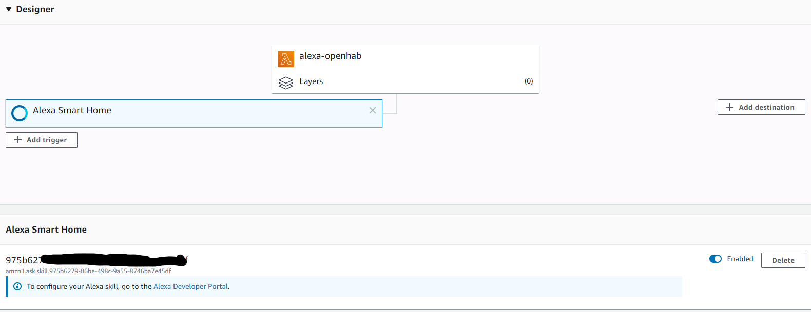

the trigger on the lambda is pointing to the correct skill/app
Your local test is showing that the communication between the function and your server is working. I am asking you to confirm that the communication between the skill and the Lambda function. It should show the same way in your Lambda logs however not triggered by your local test.
If you don’t see these requests, this means that the skill isn’t pointing to your Lambda function, probably because you have multiple skills created on your account from the previous setup you did.
Hi Jeremy,
I had absolutely no remaining skill or lambda functions as i cleared them several times. I confirmed that all links where fine etc…
BUT
I just tried deploying it on nvirginia instead of Ireland and its working PERFECTLY!!! :slight_smile: :slight_smile:
I still have no clue why, but as long as its working fine im happy :slight_smile:
