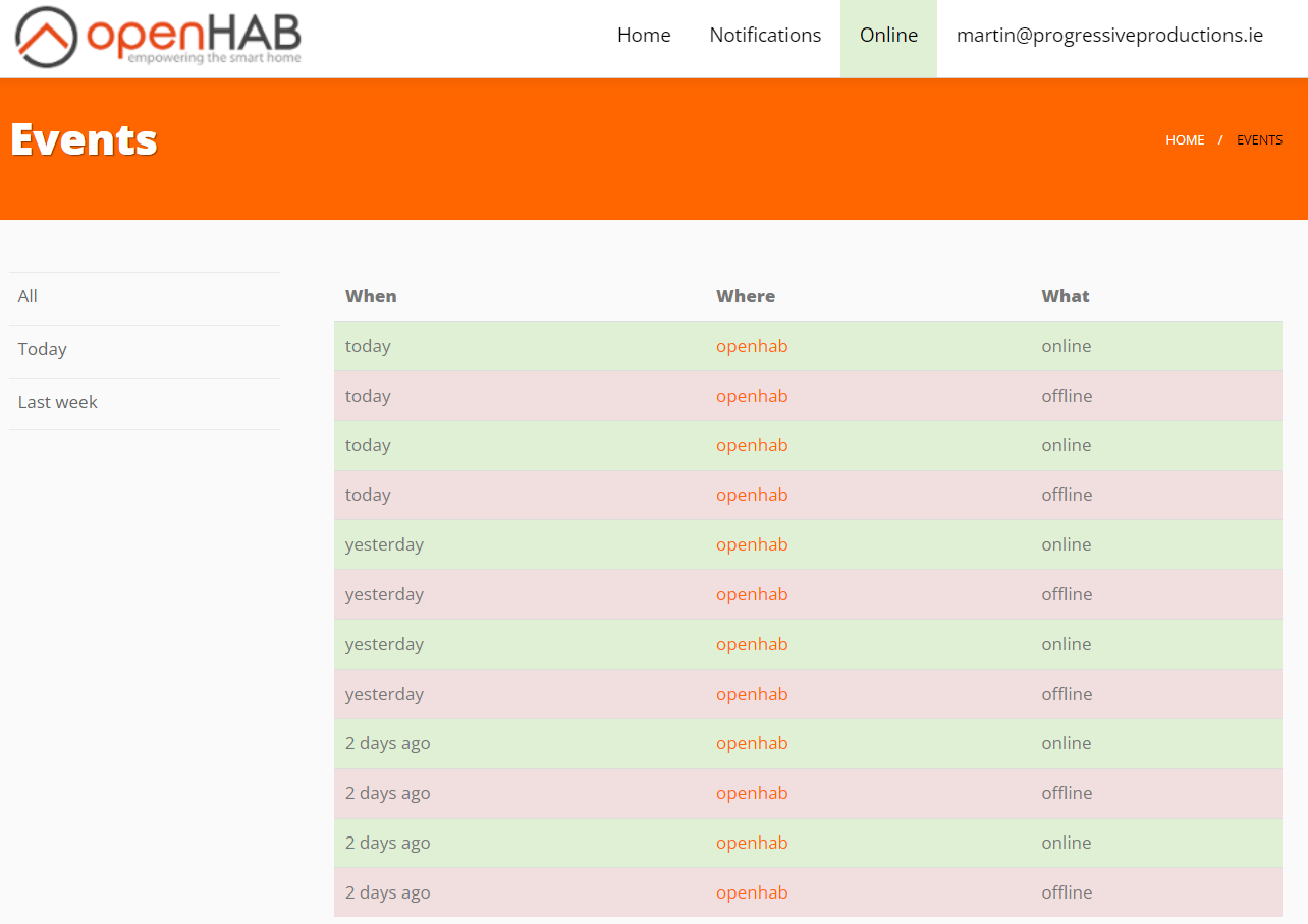

Error connecting to the openHAB Cloud instance: already connected.
When I go to https://home.myopenhab.org/ I see a dahboard from a long time ago. There is no other instances of OH running and there are no files on my Pi that have the same code as what is being displayed on the cloud.
The one on the cloud is 3.3.0, I am on 4.0.0M5 now.

I just tried changing my uuid and secret randomly in the cloud UI to something completely wrong and uninstalled the binding. It says I’m still online, but obviously not.
