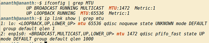

After setting mtu value = 1472 in /etc/network/interfaces, It is not reflecting in network settings.

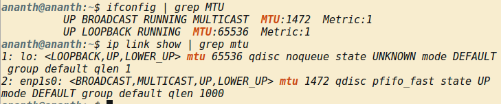

After setting MTU to 1472, Still I am not able to access the dashboard and getting the same error,
I have observed that after setting mtu size to 1472 and then pinging myopenhab.org ping -s 1472 -M do myopenhab.org is throwing error.
Later I tried to decrease the mtu size and found mtu size 1443 is not throwing error. So I set that value to mtu size like this sudo ip link set enp1s0 mtu 1443.

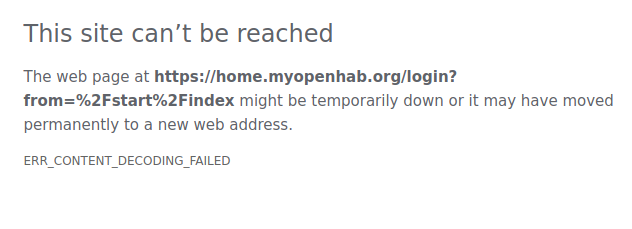

After setting mtu size ,I tried to access OH’s dashboard but I am getting the same error ERR_CONTENT_DECODING_FAILED. Still I am unable access the dashboard.

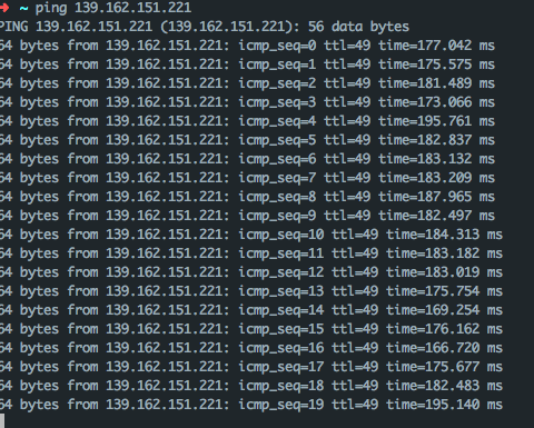

Can you ping the IP (139.162.151.221)? Any way to check with your provider if this is within a blocked range?
@Kai thanks for replying.
I check the ip
it is reachable.
check with my home service provider and they said, they didnt block the ip range or website…

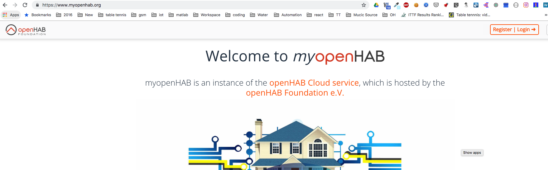

the mainpage also doesn’t open
the only page that opens in myopenhab.org with www
that leads to this:
when I click the login button at top, page doesn’t load

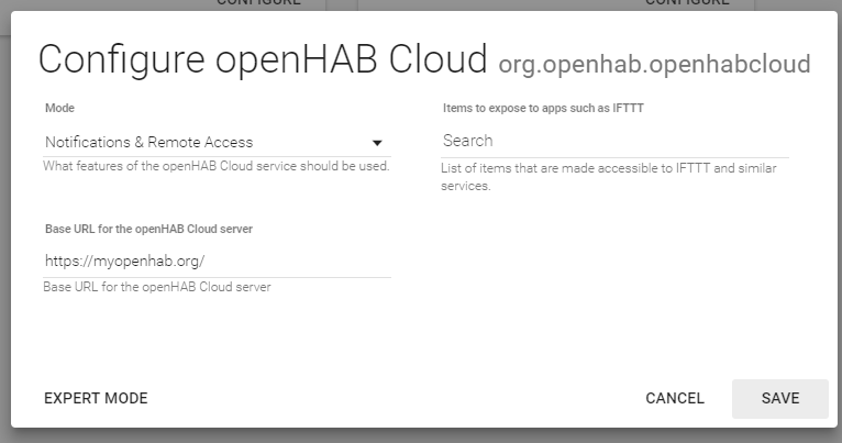

Our service is up, that error means either there is not an active connection to the service (or it thinks there is, but there is not). Can your try restarting the cloud bindle ? In the paper UI if you go to the cloud configuration screen and click save (with no changes), that should restart it ( i think)
