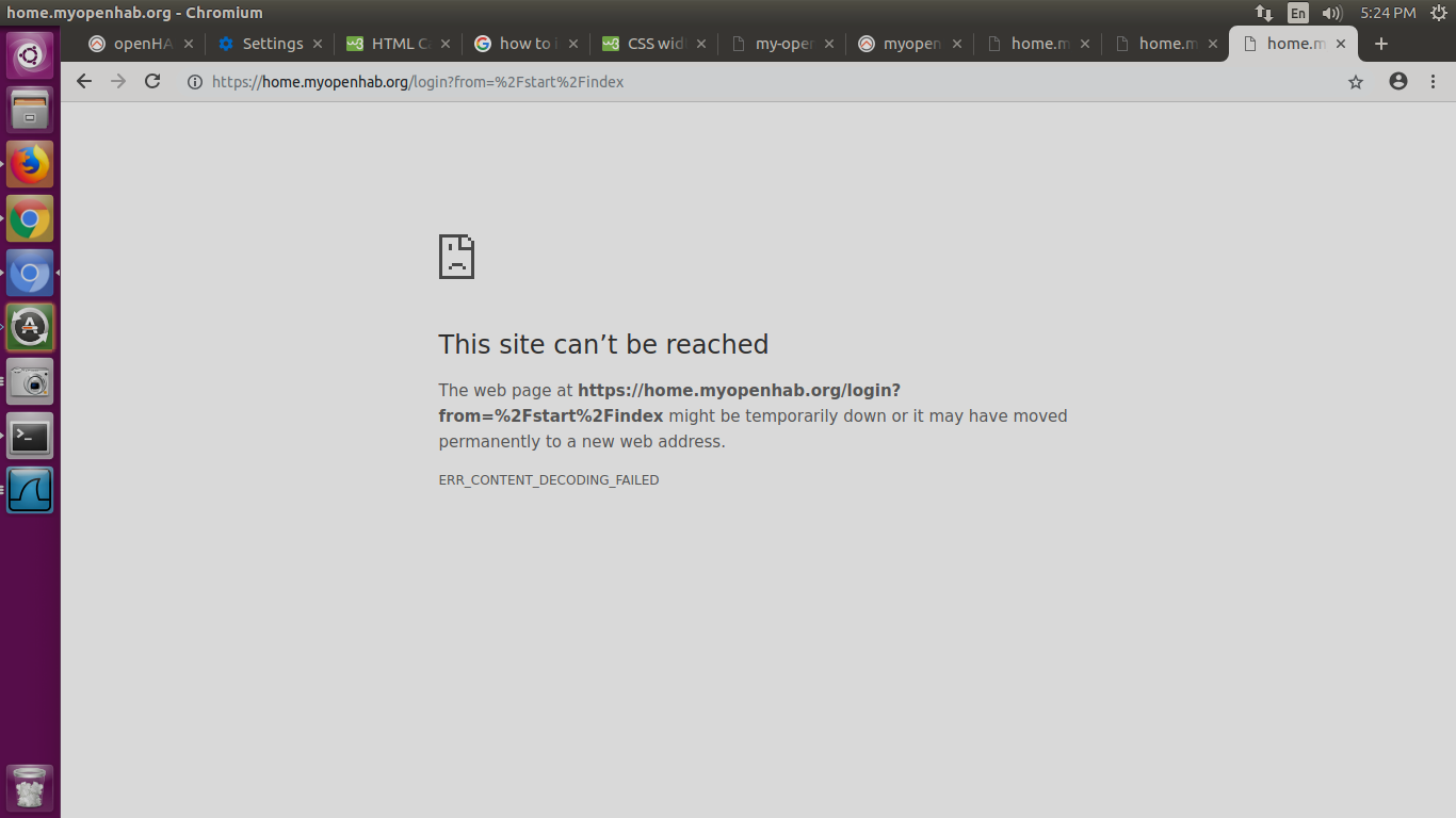

I’m out of clues!

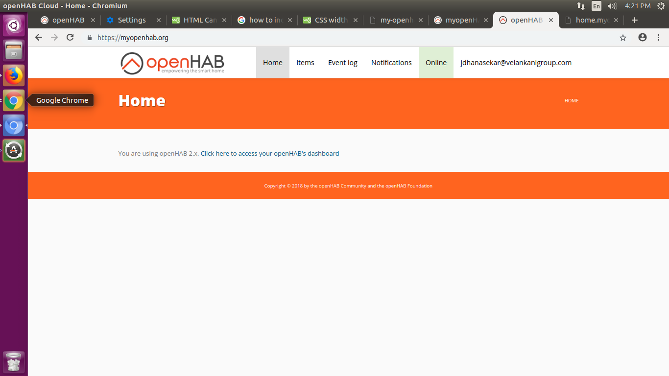

Your local openHAB instance seems to be online (see post #3), you are logged into myopenhab.org, what else could be wrong?

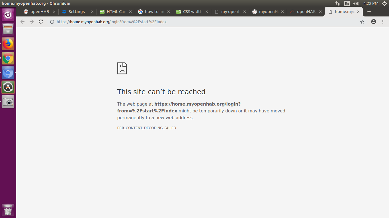

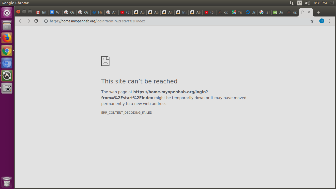

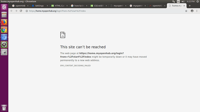

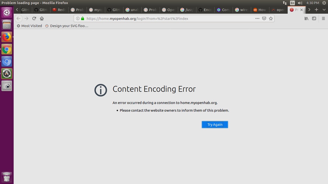

I even tried to open an “inkognito tab” when selecting the dashboard. However that resulted in a “inkongnito” tab asking for the Login credentials.

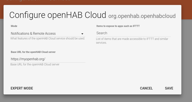

For debugging, I have entered https://localhost:8443 in Base URL for the openHAB Cloud server field and I am getting offline status in “https://myopenhab.org/”

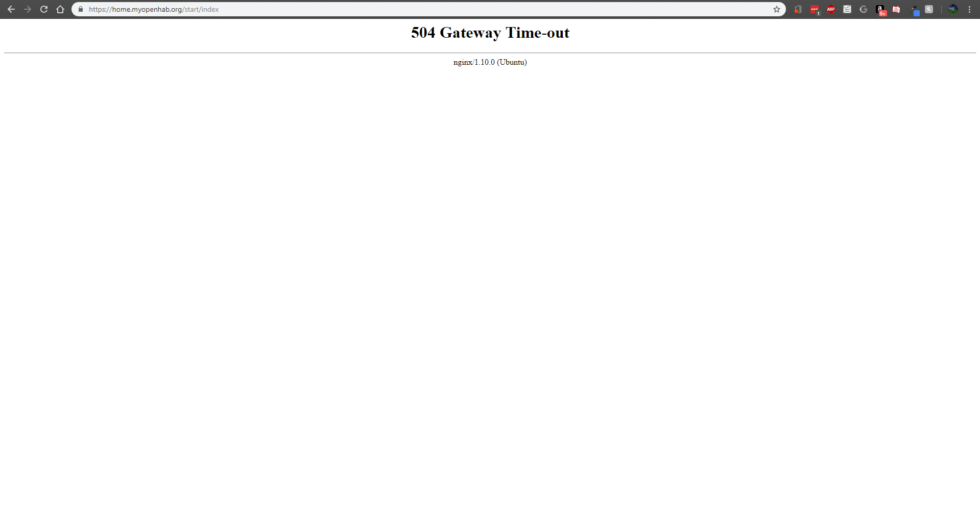

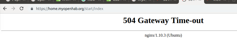

I am also getting “504 Gateway Time-out” issue. Even though I have restarted my openHAB sudo systemctl restart openhab2.service, Still I am facing the issue.

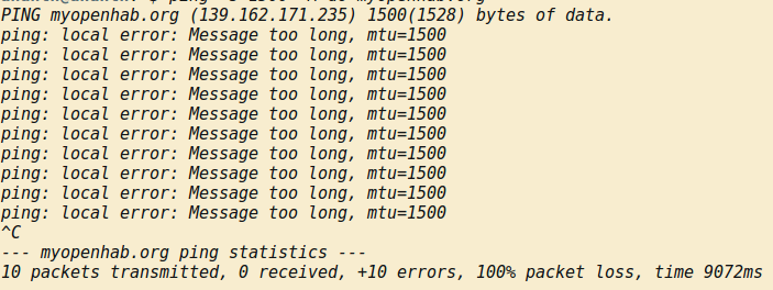

If anyone is getting the 504 error have you tried the special ping commands I posted above? Just because a browser shows the site does not mean that with a larger mtu / mru size that the ping will not fail. The error is clear the issue is it can not reach the server.
Now keep doing the ping, each time lowering the number from 1500 until you get no packet loss. Then once you have the number that works you need to add 28 to this number and set your MTU in your routers settings. Google your router/modem to find out how to find and set the MTU. This was the solution to my issues.
