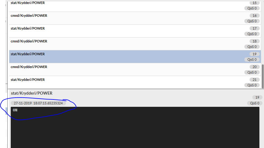

And from the MQTT, the marked state is equal to 2. last message send in Openhab 18:07:07
