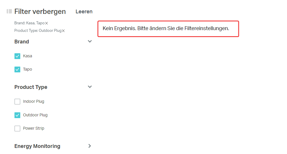

TP-Link has outdoor WiFi plugs in their Kasa and Tapo lines. There are bindings for both in openHAB. However, I don’t know if they have any that measure electricity.
