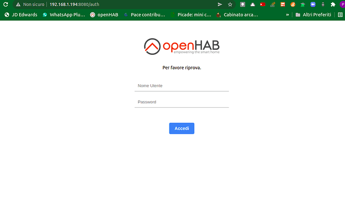

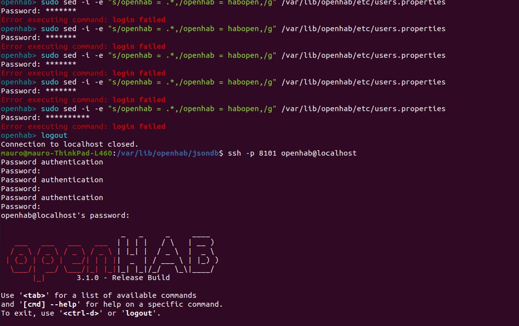

Dear collegues, I’m having trouble to enter in OpenHab Console with user and password. It seems very easy if you don’t remember the credential to reset new ones as in this tutorial is indicated (this is the link) . But I really I’m struggling with this problem because:
  1. if I try to modify them manually I struggle with the problem of Karaf Console and I cant find anything inside the “users.properties” properties file
  2. if I try to modify them by Linux shell ( sudo sed -i -e “s/openhab = .*,/openhab = securePassword,/g” /var/lib/openhab/etc/users.properties), I receive from an openhab message “Error executing command: login failed”.
    My configuration is this Openhab 3.1.0 (on raspberry)
    I launch: ssh -p 8101 openhab@localhost from Ubuntu 20.04.3 LTS
    Hoping answer to my question can be useful for other I give you 2 screenshot

Hi Wolfgang it appears so:
openhab = {CRYPT}4F61A0FD056BC0FD8231899EC4D9F9CA06AF0DEC895B2A3B0773F6FBC1C99776{CRYPT},g:admingroup
That seems to be the default entry with encryptted password habopen. Not sure where the underscores are gone:
openhab = {CRYPT}4F61A0FD056BC0FD8231899EC4D9F9CA06AF0DEC895B2A3B0773F6FBC1C99776{CRYPT},_g_:admingroup
Thank you Wolfagang. But I suppose that the problem is not in the users.properties file. In fact I changed the password but the problem with page persists.
And in openHab Log Viewer (frontail) I have this message:
2021-11-22 09:28:05.248 [WARN ] [uth.internal.AbstractAuthPageServlet] - Authentication failed: User not found: openhab
