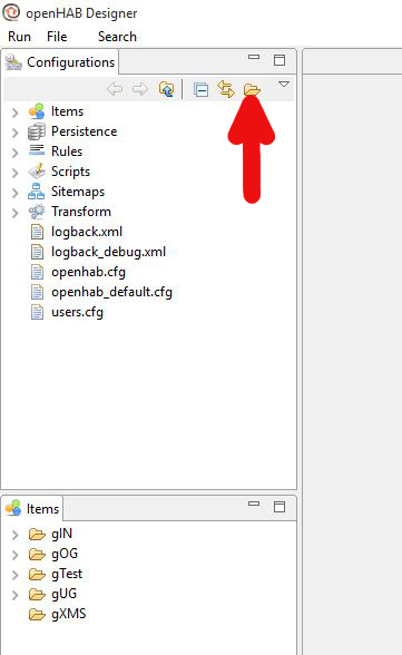

hi all
just a question. I have tried to follow to “designer guide” but still when i start the designer and tro to open the config folder, its says that the folder is not right and I have to find the right one.. anyone who can help me.. im just testing right now, so everything is running on windows
Peter
Most common problem is, you need to have the openhab_default.cfg file in place, not only your individual openhab.cfg.
Then in designer open your folder /etc/openhab and it should work.
Good luck.
Perfect.. it worked… thanks

[quote=“The4thIcon, post:11, topic:3125, full:true”]
I created the files structure \opt\openhab.
Designer doesn’t recognize it as a valid folder.[/quote]
You need to open your configuration folder, not the openhab folder itself.
