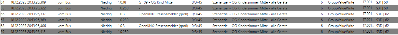

I am using openhab 5.0.3 docker with knx. In the ETS logs I found that if a scene command is sent to the bus, openhab echoes that message and sends it back to the bus. Below an example of receiveing scene 49 and 61.
I tried with openhab not running → no echoes.
I tried with all scripts and rules disabeld, in case I did some mistake that makes a rule/script send the echo → openhab still echoes.
Could somebody give me a hint towards my mistake in setup?
| line_horizontal_3 20:13:30.535 | TRACE | org.openhab.binding.knx.internal.channel.KNXChannel | getCommandSpec checking keys ‘[ga]’ for command ‘49.0’ (class org.openhab.core.library.types.DecimalType) |
| line_horizontal_3 20:13:30.535 | TRACE | org.openhab.binding.knx.internal.channel.KNXChannel | getCommandSpec key ‘ga’ has one of the expectedTypeClasses ‘[class org.openhab.core.library.types.DecimalType]’, matching command ‘49.0’ and dpt ‘17.001’ |
| line_horizontal_3 20:13:30.536 | TRACE | org.openhab.binding.knx.internal.dpt.ValueDecoder | Finally using datapoint DPT = 17.001 |
| line_horizontal_3 20:13:30.536 | TRACE | org.openhab.binding.knx.internal.handler.DeviceThingHandler | processDataReceived postCommand to channel ‘knx:device:e016ef5bd9:e4bb4d9970:SzenenKinderzimmerMitteAlleGeraete’ new value ‘[49]’ for GA ‘0/3/45’ |
| info_circle 20:13:30.537 | INFO | openhab.event.ItemCommandEvent | Item ‘Szenen_Szenen_Kinderzimmer_Mitte_alle_Gerate’ received command 49.0 |
| info_circle 20:13:30.537 | INFO | org.openhab.automation.script.ui.06f69b1506 | Skript KNX Erweiterung ausführen. |
| info_circle 20:13:30.538 | INFO | openhab.event.ItemStatePredictedEvent | Item ‘Szenen_Szenen_Kinderzimmer_Mitte_alle_Gerate’ predicted to become 49.0 |
| info_circle 20:13:30.538 | INFO | org.openhab.automation.script.ui.06f69b1506 | 49 |
| info_circle 20:13:30.539 | INFO | openhab.event.ItemStateChangedEvent | Item ‘Szenen_Szenen_Kinderzimmer_Mitte_alle_Gerate’ changed from 62.0 to 49.0 |
| info_circle 20:13:30.539 | INFO | org.openhab.automation.script.ui.06f69b1506 | Szenen_Szenen_Kinderzimmer_Mitte_alle_Gerate |
| info_circle 20:13:30.540 | INFO | org.openhab.automation.script.ui.a3b9dae9dc | Triggering item name: Szenen_Szenen_Kinderzimmer_Mitte_alle_GerateEmpfangene Szene: 49 |
| info_circle 20:13:30.541 | INFO | org.openhab.automation.script.ui.a3b9dae9dc | Steckdosenlicht schalten. |
| line_horizontal_3 20:13:30.543 | TRACE | org.openhab.binding.knx.internal.handler.DeviceThingHandler | Handling command ‘49.0’ for channel ‘knx:device:e016ef5bd9:e4bb4d9970:SzenenKinderzimmerMitteAlleGeraete’ |
| line_horizontal_3 20:13:30.544 | TRACE | org.openhab.binding.knx.internal.channel.KNXChannel | getCommandSpec checking keys ‘[ga]’ for command ‘49.0’ (class org.openhab.core.library.types.DecimalType) |
| line_horizontal_3 20:13:30.544 | TRACE | org.openhab.binding.knx.internal.channel.KNXChannel | getCommandSpec key ‘ga’ has one of the expectedTypeClasses ‘[class org.openhab.core.library.types.DecimalType]’, matching command ‘49.0’ and dpt ‘17.001’ |
| line_horizontal_3 20:13:30.544 | TRACE | org.openhab.binding.knx.internal.client.AbstractKNXClient | writeToKNX groupAddress ‘0/3/45’, commandSpec ‘0/3/45:17.001 49.0’ |
| line_horizontal_3 20:13:30.544 | TRACE | org.openhab.binding.knx.internal.client.AbstractKNXClient | sendToKNX mappedValue: ‘49’ groupAddress: ‘0/3/45’ |
| line_horizontal_3 20:13:30.562 | TRACE | org.openhab.binding.knx.internal.client.AbstractKNXClient | Received a Group Write telegram from ‘1.0.3’ to ‘0/3/45’ with value ‘[61]’ |
| ant 20:13:30.562 | DEBUG | org.openhab.binding.knx.internal.handler.DeviceThingHandler | onGroupWrite Thing ‘knx:device:e016ef5bd9:e4bb4d9970’ received a GroupValueWrite telegram from ‘1.0.3’ for destination ‘0/3/45’ |
| line_horizontal_3 20:13:30.562 | TRACE | org.openhab.binding.knx.internal.handler.DeviceThingHandler | onGroupWrite Thing ‘knx:device:e016ef5bd9:e4bb4d9970’ processes a GroupValueWrite telegram for destination ‘0/3/45’ for channel ‘knx:device:e016ef5bd9:e4bb4d9970:SzenenKinderzimmerMitteAlleGeraete’ |
| line_horizontal_3 20:13:30.562 | TRACE | org.openhab.binding.knx.internal.handler.DeviceThingHandler | onGroupWrite isControl |
| line_horizontal_3 20:13:30.563 | TRACE | org.openhab.binding.knx.internal.dpt.ValueDecoder | Finally using datapoint DPT = 17.001 |
| line_horizontal_3 20:13:30.563 | TRACE | org.openhab.binding.knx.internal.channel.KNXChannel | getCommandSpec checking keys ‘[ga]’ for command ‘61.0’ (class org.openhab.core.library.types.DecimalType) |
| line_horizontal_3 20:13:30.563 | TRACE | org.openhab.binding.knx.internal.channel.KNXChannel | getCommandSpec key ‘ga’ has one of the expectedTypeClasses ‘[class org.openhab.core.library.types.DecimalType]’, matching command ‘61.0’ and dpt ‘17.001’ |
| line_horizontal_3 20:13:30.564 | TRACE | org.openhab.binding.knx.internal.handler.DeviceThingHandler | processDataReceived postCommand to channel ‘knx:device:e016ef5bd9:e4bb4d9970:SzenenKinderzimmerMitteAlleGeraete’ new value ‘[61]’ for GA ‘0/3/45’ |
| info_circle 20:13:30.565 | INFO | openhab.event.ItemCommandEvent | Item ‘Szenen_Szenen_Kinderzimmer_Mitte_alle_Gerate’ received command 61.0 |
| info_circle 20:13:30.565 | INFO | org.openhab.automation.script.ui.06f69b1506 | Skript KNX Erweiterung ausführen. |
| info_circle 20:13:30.565 | INFO | openhab.event.ItemStatePredictedEvent | Item ‘Szenen_Szenen_Kinderzimmer_Mitte_alle_Gerate’ predicted to become 61.0 |
| info_circle 20:13:30.566 | INFO | org.openhab.automation.script.ui.06f69b1506 | 61 |
| info_circle 20:13:30.566 | INFO | openhab.event.ItemStateChangedEvent | Item ‘Szenen_Szenen_Kinderzimmer_Mitte_alle_Gerate’ changed from 49.0 to 61.0 |
| info_circle 20:13:30.566 | INFO | org.openhab.automation.script.ui.06f69b1506 | Szenen_Szenen_Kinderzimmer_Mitte_alle_Gerate |
| info_circle 20:13:30.567 | INFO | org.openhab.automation.script.ui.a3b9dae9dc | Triggering item name: Szenen_Szenen_Kinderzimmer_Mitte_alle_GerateEmpfangene Szene: 61 |
| info_circle 20:13:30.568 | INFO | org.openhab.automation.script.ui.a3b9dae9dc | Steckdosenlicht schalten. |
| flag 20:13:30.569 | WARN | org.openhab.core.automation.module.script.internal.defaultscope.ScriptBusEventImpl | Command ‘ON’ cannot be parsed for item ‘KinderzimmerMitteBeleuchtungNacht (Type=GroupItem, Members=0, State=NULL, Label=Phyllis Beleuchtung Nacht, Category=light, Groups=[AtelierLicht])’. |
| ant 20:13:30.585 | DEBUG | org.openhab.binding.knx.internal.client.AbstractKNXClient | Wrote value ‘49.0’ to datapoint ‘command DP 0/3/45 ‘knx:ip:e016ef5bd9’, DPT 17.001, low priority’ (0. attempt). |
| line_horizontal_3 20:13:30.589 | TRACE | org.openhab.binding.knx.internal.handler.DeviceThingHandler | Handling command ‘61.0’ for channel ‘knx:device:e016ef5bd9:e4bb4d9970:SzenenKinderzimmerMitteAlleGeraete’ |
| line_horizontal_3 20:13:30.590 | TRACE | org.openhab.binding.knx.internal.channel.KNXChannel | getCommandSpec checking keys ‘[ga]’ for command ‘61.0’ (class org.openhab.core.library.types.DecimalType) |
| line_horizontal_3 20:13:30.590 | TRACE | org.openhab.binding.knx.internal.channel.KNXChannel | getCommandSpec key ‘ga’ has one of the expectedTypeClasses ‘[class org.openhab.core.library.types.DecimalType]’, matching command ‘61.0’ and dpt ‘17.001’ |
| line_horizontal_3 20:13:30.590 | TRACE | org.openhab.binding.knx.internal.client.AbstractKNXClient | writeToKNX groupAddress ‘0/3/45’, commandSpec ‘0/3/45:17.001 61.0’ |
| line_horizontal_3 20:13:30.590 | TRACE | org.openhab.binding.knx.internal.client.AbstractKNXClient | sendToKNX mappedValue: ‘61’ groupAddress: ‘0/3/45’ |
| ant 20:13:30.610 | DEBUG | org.openhab.binding.knx.internal.client.AbstractKNXClient | Wrote value ‘61.0’ to datapoint ‘command DP 0/3/45 ‘knx:ip:e016ef5bd9’, DPT 17.001, low priority’ (0. attempt). |
| line_horizontal_3 20:13:30.630 | TRACE | org.openhab.binding.knx.internal.client.AbstractKNXClient | Received a Group Write telegram from ‘1.0.3’ to ‘0/3/45’ with value ‘[61]’ |
| ant 20:13:30.630 | DEBUG | org.openhab.binding.knx.internal.handler.DeviceThingHandler | onGroupWrite Thing ‘knx:device:e016ef5bd9:e4bb4d9970’ received a GroupValueWrite telegram from ‘1.0.3’ for destination ‘0/3/45’ |
| line_horizontal_3 20:13:30.631 | TRACE | org.openhab.binding.knx.internal.handler.DeviceThingHandler | onGroupWrite Thing ‘knx:device:e016ef5bd9:e4bb4d9970’ processes a GroupValueWrite telegram for destination ‘0/3/45’ for channel ‘knx:device:e016ef5bd9:e4bb4d9970:SzenenKinderzimmerMitteAlleGeraete’ |
| line_horizontal_3 20:13:30.631 | TRACE | org.openhab.binding.knx.internal.handler.DeviceThingHandler | onGroupWrite isControl |
| line_horizontal_3 20:13:30.631 | TRACE | org.openhab.binding.knx.internal.dpt.ValueDecoder | Finally using datapoint DPT = 17.001 |
| line_horizontal_3 20:13:30.631 | TRACE | org.openhab.binding.knx.internal.channel.KNXChannel | getCommandSpec checking keys ‘[ga]’ for command ‘61.0’ (class org.openhab.core.library.types.DecimalType) |
| line_horizontal_3 20:13:30.632 | TRACE | org.openhab.binding.knx.internal.channel.KNXChannel | getCommandSpec key ‘ga’ has one of the expectedTypeClasses ‘[class org.openhab.core.library.types.DecimalType]’, matching command ‘61.0’ and dpt ‘17.001’ |
| line_horizontal_3 20:13:30.632 | TRACE | org.openhab.binding.knx.internal.dpt.ValueDecoder | Finally using datapoint DPT = 17.001 |
| line_horizontal_3 20:13:30.632 | TRACE | org.openhab.binding.knx.internal.handler.DeviceThingHandler | processDataReceived postCommand to channel ‘knx:device:e016ef5bd9:e4bb4d9970:SzenenKinderzimmerMitteAlleGeraete’ new value ‘[61]’ for GA ‘0/3/45’ |
| info_circle 20:13:30.634 | INFO | openhab.event.ItemStatePredictedEvent | Item ‘Szenen_Szenen_Kinderzimmer_Mitte_alle_Gerate’ predicted to become 61.0 |
| info_circle 20:13:30.634 | INFO | org.openhab.automation.script.ui.06f69b1506 | Skript KNX Erweiterung ausführen. |
| info_circle 20:13:30.638 | INFO | org.openhab.automation.script.ui.06f69b1506 | 61 |
| info_circle 20:13:30.639 | INFO | org.openhab.automation.script.ui.06f69b1506 | Szenen_Szenen_Kinderzimmer_Mitte_alle_Gerate |
| line_horizontal_3 20:13:30.639 | TRACE | org.openhab.binding.knx.internal.handler.DeviceThingHandler | Handling command ‘61.0’ for channel ‘knx:device:e016ef5bd9:e4bb4d9970:SzenenKinderzimmerMitteAlleGeraete’ |
| line_horizontal_3 20:13:30.640 | TRACE | org.openhab.binding.knx.internal.channel.KNXChannel | getCommandSpec checking keys ‘[ga]’ for command ‘61.0’ (class org.openhab.core.library.types.DecimalType) |
| info_circle 20:13:30.640 | INFO | org.openhab.automation.script.ui.a3b9dae9dc | Triggering item name: Szenen_Szenen_Kinderzimmer_Mitte_alle_GerateEmpfangene Szene: 61 |
| line_horizontal_3 20:13:30.640 | TRACE | org.openhab.binding.knx.internal.channel.KNXChannel | getCommandSpec key ‘ga’ has one of the expectedTypeClasses ‘[class org.openhab.core.library.types.DecimalType]’, matching command ‘61.0’ and dpt ‘17.001’ |
| line_horizontal_3 20:13:30.640 | TRACE | org.openhab.binding.knx.internal.client.AbstractKNXClient | writeToKNX groupAddress ‘0/3/45’, commandSpec ‘0/3/45:17.001 61.0’ |
| line_horizontal_3 20:13:30.641 | TRACE | org.openhab.binding.knx.internal.client.AbstractKNXClient | sendToKNX mappedValue: ‘61’ groupAddress: ‘0/3/45’ |
| info_circle 20:13:30.641 | INFO | org.openhab.automation.script.ui.a3b9dae9dc | Steckdosenlicht schalten. |
| flag 20:13:30.642 | WARN | org.openhab.core.automation.module.script.internal.defaultscope.ScriptBusEventImpl | Command ‘ON’ cannot be parsed for item ‘KinderzimmerMitteBeleuchtungNacht (Type=GroupItem, Members=0, State=NULL, Label=Phyllis Beleuchtung Nacht, Category=light, Groups=[AtelierLicht])’. |
| ant 20:13:30.661 | DEBUG | org.openhab.binding.knx.internal.client.AbstractKNXClient | Wrote value ‘61.0’ to datapoint ‘command DP 0/3/45 ‘knx:ip:e016ef5bd9’, DPT 17.001, low priority’ (0. attempt). |
