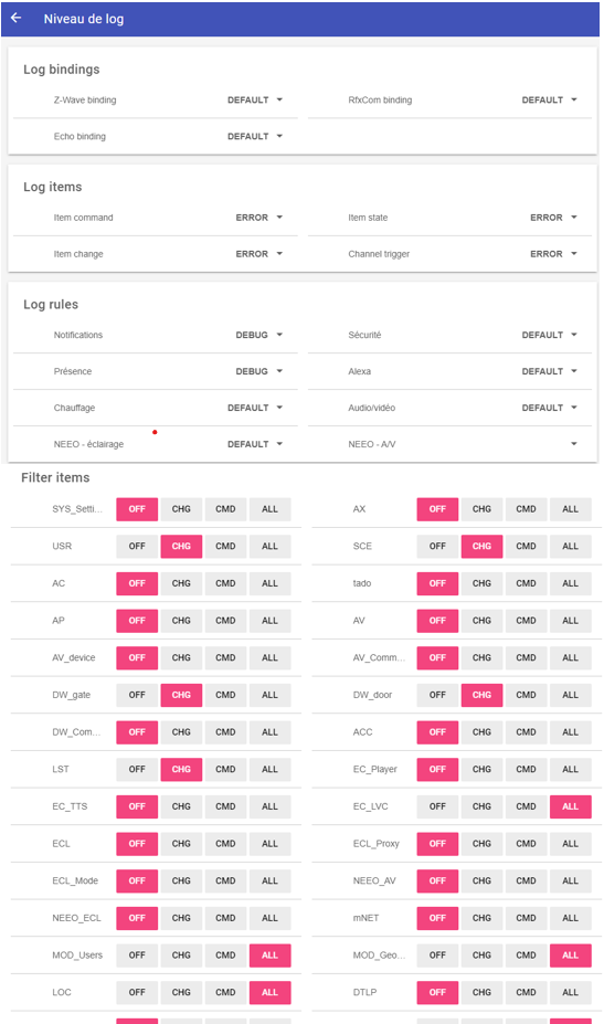

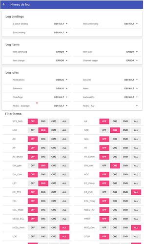

  1. I created Group items for each category to monitor and attached the corresponding items to these groups. For example, to monitor items related to alarm system, I created a group named SEC_Alarm and assign to items in the definition in the .items file
    Group SEC_AlarmMode Number SEC_System_AlarmMode_G1 "Garage côté rue" <_garagerue> (SEC_AlarmMode) {autoupdate = "false" } Number SEC_System_AlarmMode_G2 "Garage de l'impasse" <_garageimpasse> (SEC_AlarmMode) {autoupdate = "false" } Number SEC_System_AlarmMode_Cave "Cave" <_cave> (SEC_AlarmMode) {autoupdate = "false" } Number SEC_System_AlarmMode_HomeAxs "Accès maison" <_access> (SEC_AlarmMode) {autoupdate = "false" } Number SEC_System_AlarmMode_HomeMvt "Mouvements maison" <_motion> (SEC_AlarmMode) {autoupdate = "false" }
  2. I created a Number item that holds the expected level of monitoring: 0=no monitoring, 1=monitor changes, 2=monitor commands, 3 (1+2)=monitor both changes and commands
    Number SYS_LogGroup_SEC_AlarmMode "SEC_AlarmMode" (SYS_LogGroup)
    This item is exposes in the sitemap and allows changing the log level from the UI

Yes, grep is fine for few items but becomes unhandy when many items are involved. I am also using a 3rd party log viewer but filtering “on the fly” is more convenient to me. My intend is not replace the standard logger that is alreay configurable using org.ops4j.pax.logging. But it provides a configurable “on the fly” filtering method that can be useful and shoudl remain temporary while debugging (at least that is useful to me).
I initially used a filter, but for some reason, this raised errors time to time which remains a mystery to me, so that “ugly” multilined code.
The bitWiseAnd determines which event (change, update, command) should be logged based on the value of the “Filter items” in the sitemap belows.: I run similar rules to log commands and updates.
