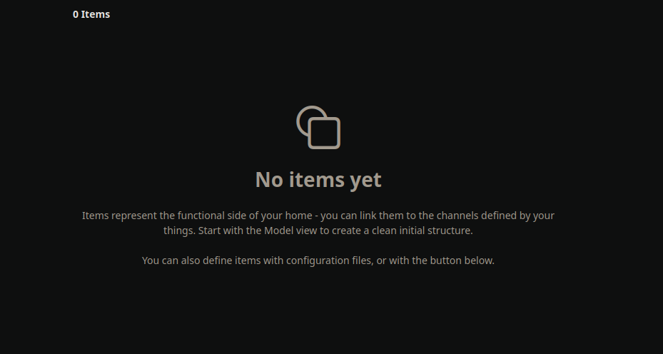

And items also empty

You always have to create Items.
