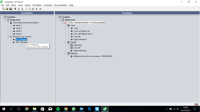

Why are you sending commands to the push button? Use the output!!!
@jmv_driver
Because that button is linked to my IHC Output?
read this thread: IHC / ELKO Binding, OH2, Amazon Echo skill - #5 by jmv_driver
You don’t need to map any input! Inputs are only mapped to access values from sensors. Otherwise you should map all the outputs of the lights

The problem you are mapping the INPUT to change from OFF to ON and then changing the INPUT from ON to OFF!!!
What is happening to you, in the first movement the light turns ON, and in the next movement you will turn the light OFF!!
you should thing that you are changing the input value variable of the input programatically, and will cause one desynchronized value from what you are getting in the module…
That why I told you to map the OUTPUTS, otherwise you are simulating the push button press and will lead to different behaviours you are expecting…
@jmv_driver
Hey Jaime,
Sorry for not understanding it right away, because I thought I was using the OUTPUT. At least it is called an Output when I look in my IHC Controller.
What OUTPUT is it that you are referring to then? The Output you are referring to is the one highlighted in the picture.
Switch BathroomEntre_tleft_IHC_PUSH "Spot Loft" (Light) { ihc="0x3DA12" }
That’s the item I’m pointing towards the Output from my IHC.
the resource id 0x3DA12 is one output port from one output module? You named the switch as “left_IHC_PUSH” for me this maps one input port not one output port.
@jmv_driver
Well, my IHC Push is of course an input since when I press the button it needs to trigger the output module where my cable goes from towards the LED spots. My IHC buttons are all wireless.
I could also change my naming of the switch, but that doesn’t change the fact that the button in Openhab does what also happens if I press the key manually and my light in the bathroom turns on. If I then press again it turns off. It’s only when running it in my rule that it turns on the light, but it never turns it off again.

You are doing the binding wrong…
this should be the value you should bind!
if you want to simulate one toggle you should send one ON command, and then one OFF command…
Everything works, you just need to understand how the system works.
If this is not the IHC thing you use, send me the reference and I can help you. But forget about to trigger inputs!!!
Hi Jaime,
I am trying to bind it just like you are stating above, but I have serious trouble finding the resource ID. When I do a “mouse over” like you are doing in the screenshot, I don’t get that ID shown. Mine just says “LK IHC wireless product”…So I am searching through the .VIS file trying to locate the ID…
Any ideas?
Thank you very much for any reply - I am stuck:slight_smile:
Try to hold the ctrl button on the keyboard, when you make the mouse over. :slight_smile:
Ah you gotta be kidding:-)
It works - how nice is that! If have been searching through the files in notepad….
Thanks a lot!
