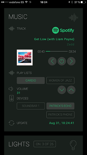

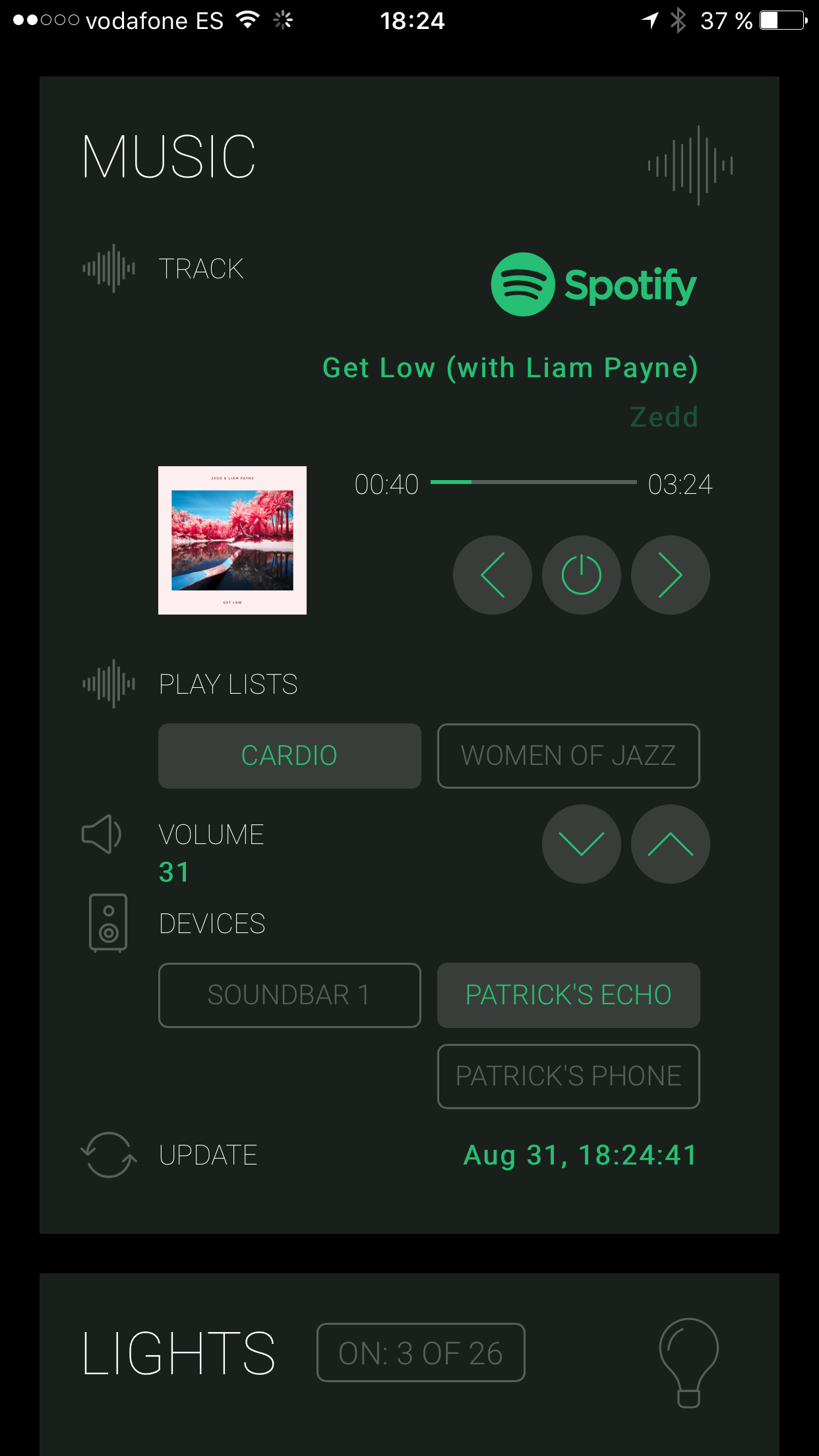

I adapted my HapPanel theme like this. Are you using my theme?
Yes, please share :slight_smile:
Here you go:
You’ll need to get the latest versions from github for:
matrix-theme.css
spotify.py
spotify.items

				<div class="scene" ng-class="{true:'on', false:''}[itemValue('spotify_current_context_uri')=='spotify:user:spotify:playlist:37i9dQZF1DWSJHnPb1f0X3']" ng-click="sendCmd('spotify_action', 'play spotify:user:spotify:playlist:37i9dQZF1DWSJHnPb1f0X3')">Cardio</div>
			</div>
		</div>
		<div class="widget">
			<div class="icon off"><svg viewBox="0 0 48 48"><use xlink:href="/static/matrix-theme/squidink.svg#volume"></use></svg></div>
			<div class="name">Volume<div class="value">{{itemValue('spotify_current_volume')}}</div></div>
			<div class="controlGroup">
				<div class="control" ng-click="sendCmd('spotify_action', 'volume_up')"><svg viewBox="0 0 80 80"><use xlink:href="/static/matrix-theme/squidink.svg#top-arrow-2"></use></svg></div>
				<div class="control" ng-click="sendCmd('spotify_action', 'volume_down')"><svg viewBox="0 0 80 80"><use xlink:href="/static/matrix-theme/squidink.svg#down-arrow-2"></use></svg></div>
			</div>
		</div>
			<div class="icon off"><svg viewBox="0 0 48 48"><use xlink:href="/static/matrix-theme/squidink.svg#box"></use></svg></div>
			<div class="name">Devices</div>
			<div class="sceneGroup" ng-init="deviceList = $eval(itemValue('spotify_device_list'))">
				<div class="scene" ng-class="{true:'on', false:''}[itemValue('spotify_current_device_id')==device.id]" ng-repeat="device in deviceList" ng-click="sendCmd('spotify_current_device_id', device.id)">{{device.name}}</div>
			</div>
		</div>
		<div class="widget" ng-click="sendCmd('spotify_forceupadte', 'ON')">
			<div class="icon off"><svg viewBox="0 0 48 48"><use xlink:href="/static/matrix-theme/squidink.svg#double-arrow"></use></svg></div>
			<div class="name">Update</div>
     	<div class="valueGroup">
        <div class="value">{{itemValue('spotify_lastConnectionDateTime') | date:'MMM d, HH:mm:ss'}}</div>
      </div>
		</div>
  </div>
</div>
