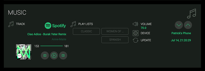

Here’s a python script that integrates the Spotify player API (work in progress):
Thanks to this script/rules, I can set up a HabPanel like the screenshot above.

Thank you, Spotify integration is great. I did all the procedures to allow spotify.py to function.
I am struggling to find how to get this into my Habpanel (I am not yet on your great theme). Do I add each item on a widget (if so which type)? Or do i import widgets somewhere?
Thank you.
You might want to have a look at the HabPanel thread which has a really cool interface.
I plan on moving over when I get a chance.
Yes, thanks. I have tried the .css stylesheet, but have a long ways to go on my panel. Just want to see if it works in the default panel as well. i suppose not to get the interactive functions?
I just tried habpanel for the first time and it seems to work if you follow the instructions here GitHub - pmpkk/openhab-habpanel-theme-matrix: A custom theme for OpenHab HabPanel.
The spotify interface is on the “ground floor widget” which is “interactive”.
Before that I had made my own makeshift controls and interface in a sitemap accessed through the basic ui, which was basically just adding the spotify items. (The script is a bit nicer now so you may need to add a rule and make some virtual items to trigger them to play/pause, etc.)
