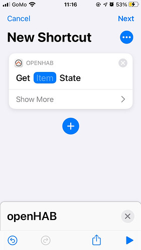

How does this thing work?
What I’m trying below doesn’t work.

I am now assuming that ithe “item” in blue should be clickable to show a list of items in the OpenHab app (sitemap items).

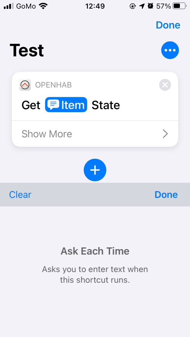

Press and hold the item button. Select ask always. Now it will get all your item.
Now you can click on item an selcet the one you want to.

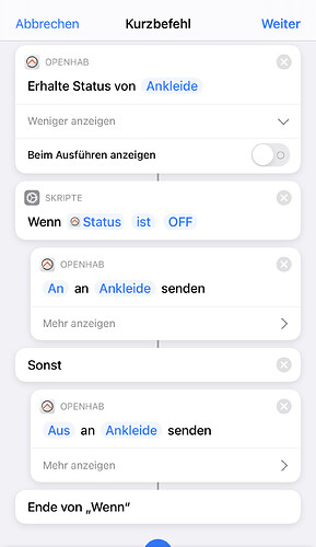

e.g.
Really basic shortcut to turn a light on or off.

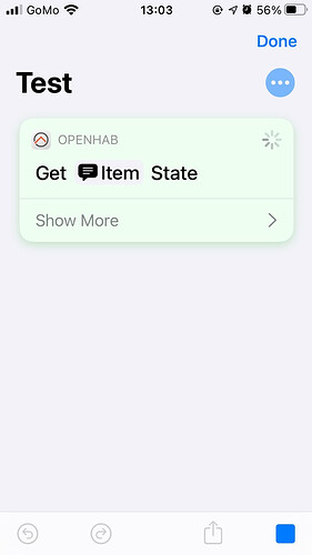

Did it take long to cache? It’s been running for over 5 mins and it’s still spinning.

Mine is just spinning forever. I’ve tried quitting the apps and restarting but can’t think of anything else to try.

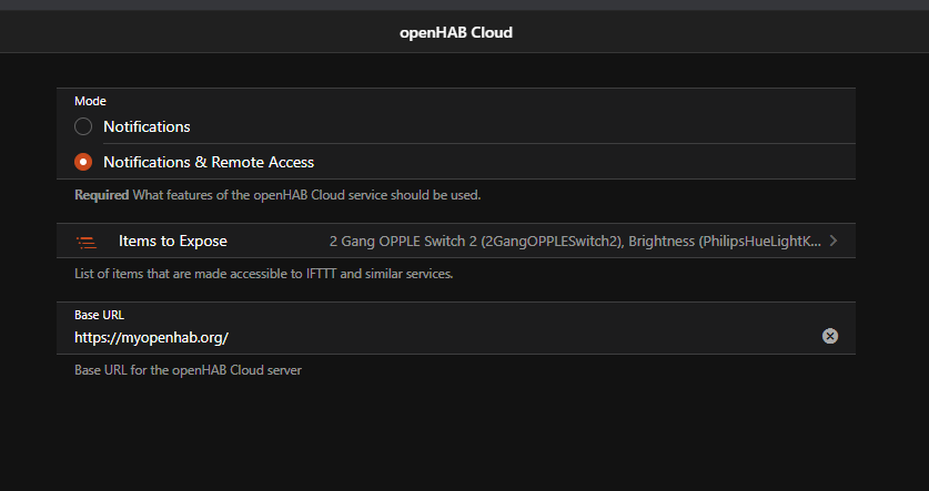

Could it be something to do with this screen?
Should the Base URL be different?

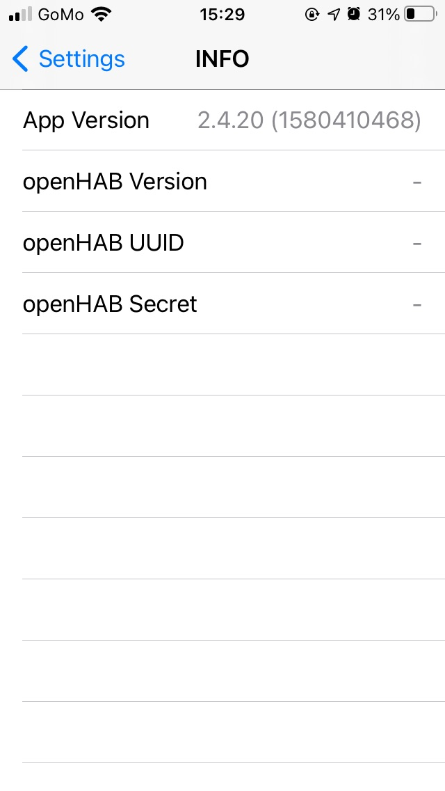

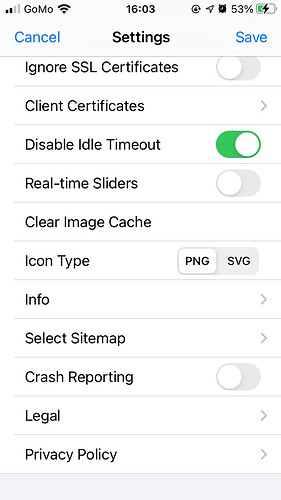

Also, not sure if this is related, but I don’t see info here where I used to:
Checked mine, exactly the same. I exposed all items to myopenhab, base url is the same like yours (make sure it is the same in your openhab app) and the Info is also the same like your screenshot. Only App version is available and the rest got a - .
Please don’t expose any Item unless there is a real need for it (like it was for IFTTT), this produces unneeded/unwanted load on our servers.
Alexa or Google Assistant work with proper tagging, no need to expose.
Even the IOS Shortcut App will find unexposed Items, as it does a REST API request through openHAB APP.

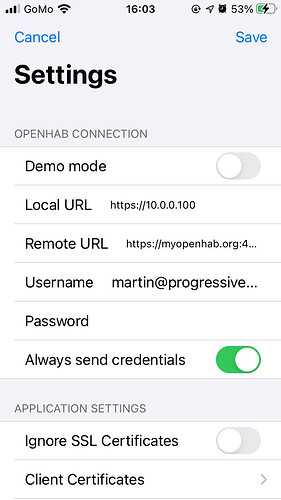

My url in my app is https://myopenhab.org:443 as I was directed by the installation process. Neither changing my Main UI to match my phone or changing my phone to match my Main UI worked.

Whenever I remove the Remote URL my sitemap diasappears and the field is auto filled with “https://openhab.org:8444
