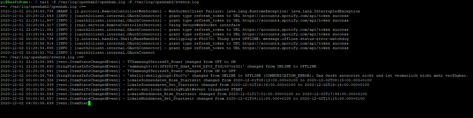

My /var/log/openhab2/openhab.log and /var/log/openhab2/events.log suddenly stopped working on 02.12.2020 04:50:08am as you can see in my screenshot for the logs.
Several reboots of the Pi and restarts of openHab with cleaning the beforehand cache didn’t change the situation. The SD card don’t seem to be failing, everything else is just running fine.

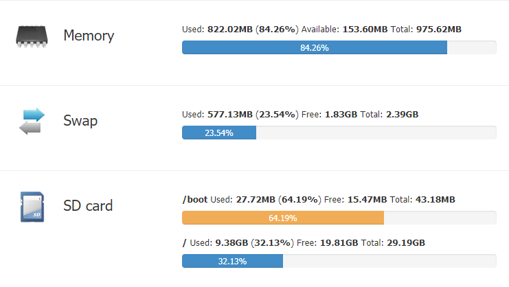

Filesystem in terms of space looks good to me I guess:

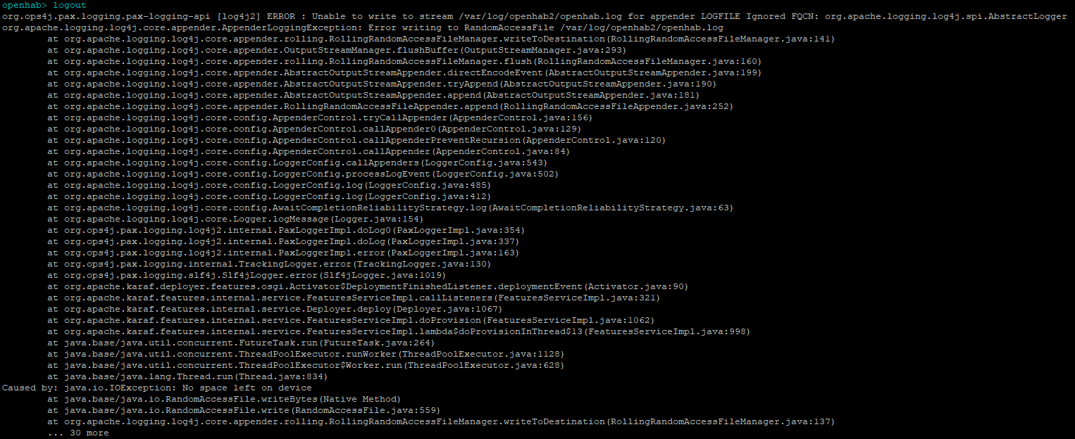

I was able to investigate a but further, maybe someone can help with the debug logs? I used openhab-cli start --debug to find something, this came out after logging out:
openhab> logout
org.ops4j.pax.logging.pax-logging-api [log4j2] ERROR : Unable to write to stream /var/log/openhab2/openhab.log for appender LOGFILE Ignored FQCN: org.apache.logging.log4j.spi.AbstractLogger
org.apache.logging.log4j.core.appender.AppenderLoggingException: Error writing to RandomAccessFile /var/log/openhab2/openhab.log
        at org.apache.logging.log4j.core.appender.rolling.RollingRandomAccessFileManager.writeToDestination(RollingRandomAccessFileManager.java:141)
        at org.apache.logging.log4j.core.appender.OutputStreamManager.flushBuffer(OutputStreamManager.java:293)
        at org.apache.logging.log4j.core.appender.rolling.RollingRandomAccessFileManager.flush(RollingRandomAccessFileManager.java:160)
        at org.apache.logging.log4j.core.appender.AbstractOutputStreamAppender.directEncodeEvent(AbstractOutputStreamAppender.java:199)
        at org.apache.logging.log4j.core.appender.AbstractOutputStreamAppender.tryAppend(AbstractOutputStreamAppender.java:190)
        at org.apache.logging.log4j.core.appender.AbstractOutputStreamAppender.append(AbstractOutputStreamAppender.java:181)
        at org.apache.logging.log4j.core.appender.RollingRandomAccessFileAppender.append(RollingRandomAccessFileAppender.java:252)
        at org.apache.logging.log4j.core.config.AppenderControl.tryCallAppender(AppenderControl.java:156)
        at org.apache.logging.log4j.core.config.AppenderControl.callAppender0(AppenderControl.java:129)
        at org.apache.logging.log4j.core.config.AppenderControl.callAppenderPreventRecursion(AppenderControl.java:120)
        at org.apache.logging.log4j.core.config.AppenderControl.callAppender(AppenderControl.java:84)
        at org.apache.logging.log4j.core.config.LoggerConfig.callAppenders(LoggerConfig.java:543)
        at org.apache.logging.log4j.core.config.LoggerConfig.processLogEvent(LoggerConfig.java:502)
        at org.apache.logging.log4j.core.config.LoggerConfig.log(LoggerConfig.java:485)
        at org.apache.logging.log4j.core.config.LoggerConfig.log(LoggerConfig.java:412)
        at org.apache.logging.log4j.core.config.AwaitCompletionReliabilityStrategy.log(AwaitCompletionReliabilityStrategy.java:63)
        at org.apache.logging.log4j.core.Logger.logMessage(Logger.java:154)
        at org.ops4j.pax.logging.log4j2.internal.PaxLoggerImpl.doLog0(PaxLoggerImpl.java:354)
        at org.ops4j.pax.logging.log4j2.internal.PaxLoggerImpl.doLog(PaxLoggerImpl.java:337)
        at org.ops4j.pax.logging.log4j2.internal.PaxLoggerImpl.error(PaxLoggerImpl.java:163)
        at org.ops4j.pax.logging.internal.TrackingLogger.error(TrackingLogger.java:130)
        at org.ops4j.pax.logging.slf4j.Slf4jLogger.error(Slf4jLogger.java:1019)
        at org.apache.karaf.deployer.features.osgi.Activator$DeploymentFinishedListener.deploymentEvent(Activator.java:90)
        at org.apache.karaf.features.internal.service.FeaturesServiceImpl.callListeners(FeaturesServiceImpl.java:321)
        at org.apache.karaf.features.internal.service.Deployer.deploy(Deployer.java:1067)
        at org.apache.karaf.features.internal.service.FeaturesServiceImpl.doProvision(FeaturesServiceImpl.java:1062)
        at org.apache.karaf.features.internal.service.FeaturesServiceImpl.lambda$doProvisionInThread$13(FeaturesServiceImpl.java:998)
        at java.base/java.util.concurrent.FutureTask.run(FutureTask.java:264)
        at java.base/java.util.concurrent.ThreadPoolExecutor.runWorker(ThreadPoolExecutor.java:1128)
        at java.base/java.util.concurrent.ThreadPoolExecutor$Worker.run(ThreadPoolExecutor.java:628)
        at java.base/java.lang.Thread.run(Thread.java:834)
Caused by: java.io.IOException: No space left on device
        at java.base/java.io.RandomAccessFile.writeBytes(Native Method)
        at java.base/java.io.RandomAccessFile.write(RandomAccessFile.java:559)
        at org.apache.logging.log4j.core.appender.rolling.RollingRandomAccessFileManager.writeToDestination(RollingRandomAccessFileManager.java:137)
        ... 30 more

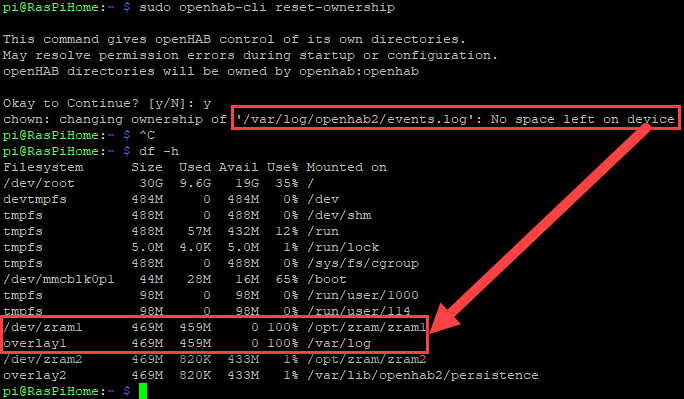

After further investigating I tried to reset the permission / ownership via the Karaf console. Turns out that there is no space left (why ever). My first thought was indeed a damaged SD card, but checking the filesystem with df -h showed me that there is no space left for logs:
Any hints how to solve this?

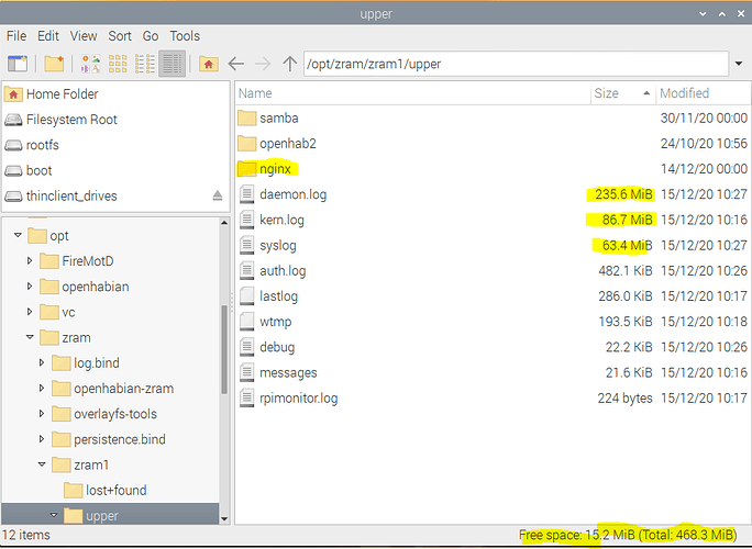

In the red marked zram1 folder from my screenshot above are many old gzipped files, how can I remove them properly and how can I setup zram logrotate to prevent this issue for the future?
The /var/log/ folder also have a lot of gzipped files
Edit: I’m afraid the logging will stop soon, the zram1 folder will run out of space in the next hour. Those are the most heavy files. Any idea how to avoid the growing of the logfiles?

I checked the large daemon.log and syslog and saw that my influxdb was creating several records per second in the affected logfiles. I disabled the unnecessary logging from the influxdb config and cleared the logfiles with the following commands (not pretty, I know):
[11:19:02] root@RasPiHome:/home/pi# > /opt/zram/zram1/upper/syslog
[11:19:13] root@RasPiHome:/home/pi# > /opt/zram/zram1/upper/daemon.log
[11:19:38] root@RasPiHome:/home/pi# > /opt/zram/zram1/upper/kern.log
From now on the logging was reduced heavily and the space increased up to 400mb. Now everything should be fine with logrotate and not too large logfiles, even if in the last 8 hours a few mb of logs were written.
