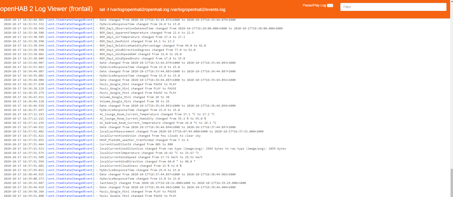

Hi @Zitelli
Did you have any more issues with this? I have just noticed after restarting openhab a massive hole in my logs events.log and openhab.log. Current sizes are events about 11meg openhab just over 2meg.
Screenshot 2020-10-16 at 22.55.15
The last timestamps in the logs are as follows, you may note that there is a java error there. Yes there is and it is another issue I am chasing but this doesn’t account for loss of logs when I have been monitoring in real-time in frontail across this hole! Strange.

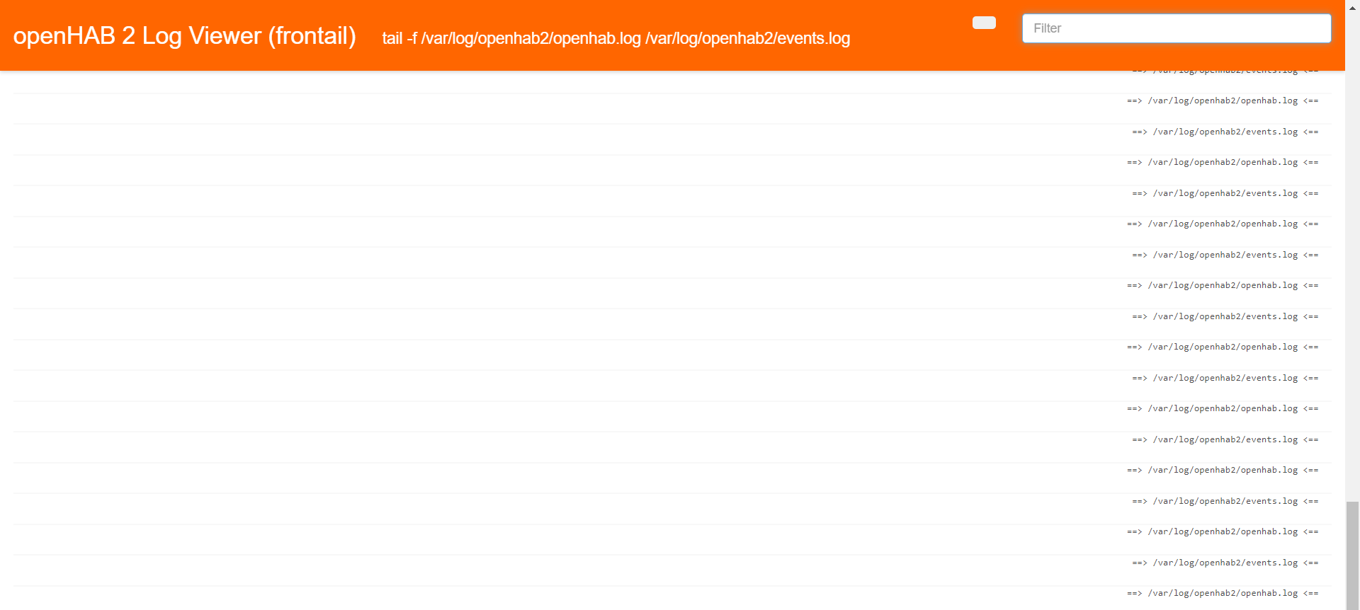

Yes, same thing happened again, see att. pictures. I will probably have to delete those files again to make it work again.
@lloydatron: I don’t receive any error message, it just stops logging.
Yeah there is defiantly something amiss it should look like.
