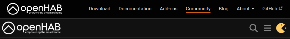

You can see this CSS while using the Developer tools and also disable it to undo these tweaks:
disable-tweaks
Without these tweaks it will show the two logos again though :face_with_diagonal_mouth::
So it is only an issue in the openHAB Discourse instance because of this configuration.
