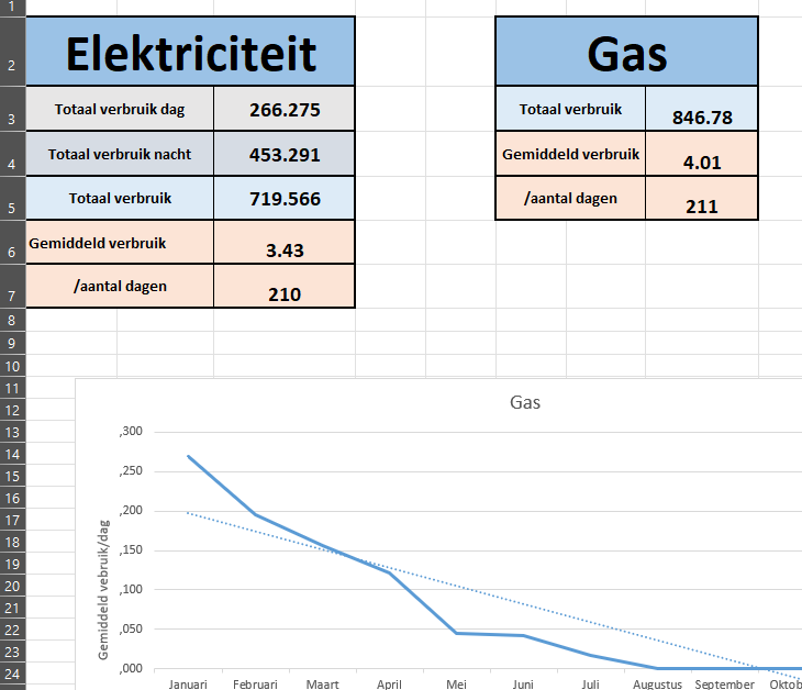

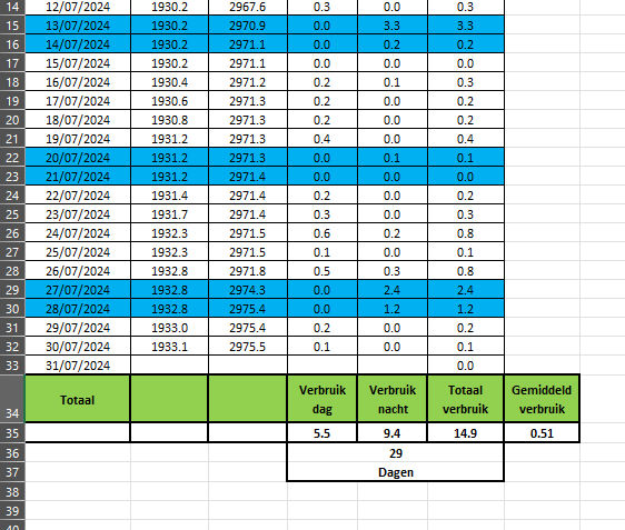

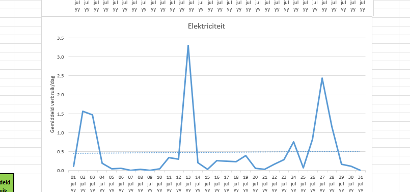

Below is an example of how my excel is structured.
I enter the meter reading every day.
It is then calculated relative to the day before how much was consumed that day itself. This for the day and night consumption separately and a total consumption for that day.
At the bottom of the table the consumptions are then added together and an average calculated based on the number of days that month.
Also, a graph is made of the consumption per month.
And I have a total overview of the whole year.

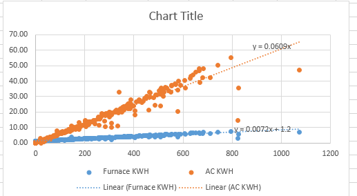

As an excel geek, I won’t go into great detail, but like the code above, I get a midnight reading of KWH from all my meters (which basically cover everything), then use mysql DB (running in a docker container) to capture. Then I use the import data capability of excel where I do whatever (like compare with the utility bill). With one click all the data is imported. Have 2.5+ years of daily data at this point. I’m sure there are other options, but after some early struggles this works for me.
Screen shot of the component compare to the house meter.
This won’t mean much, but I do custom graphs too.
