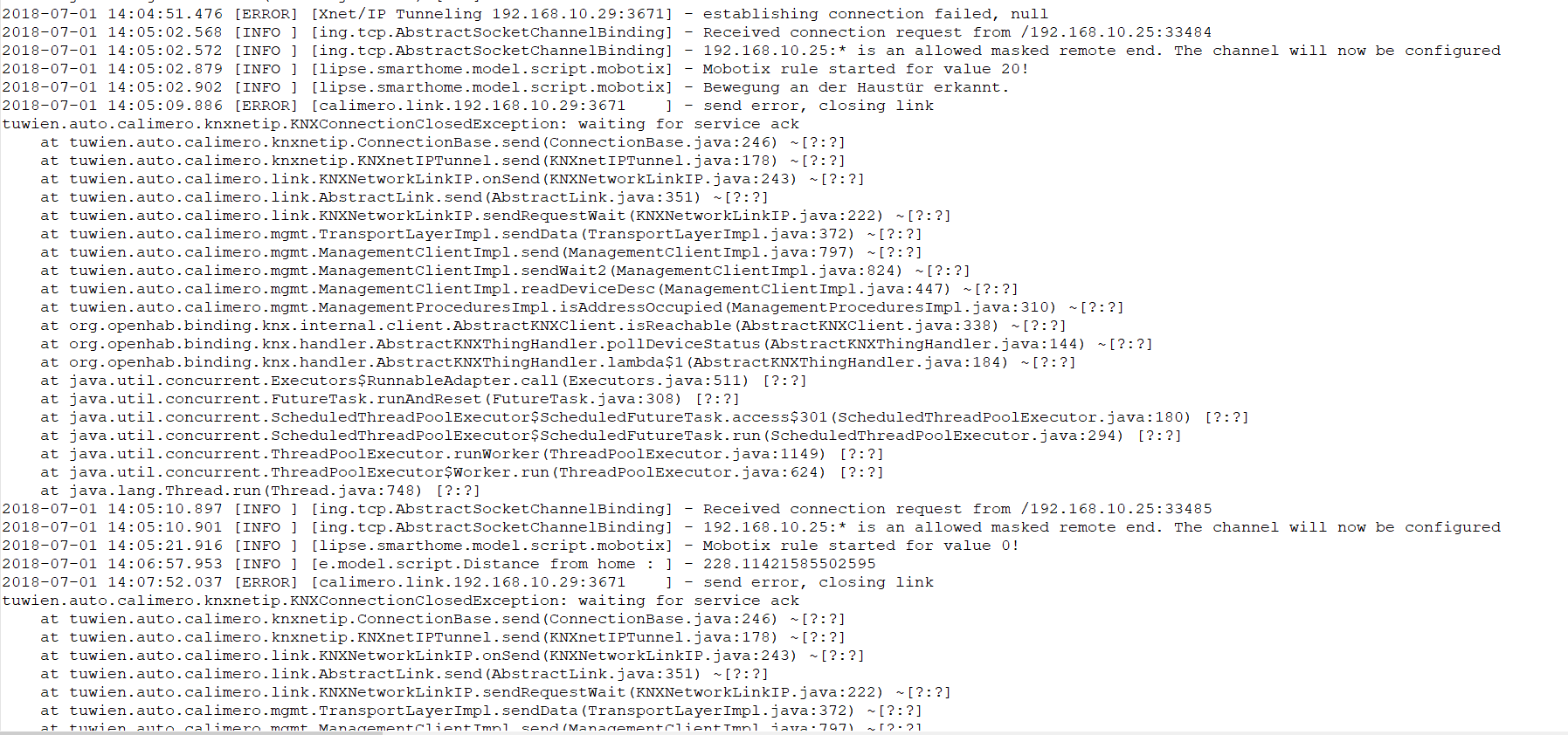

    I have no idea why, but openhab is constantly losing connection to the KNX bus. Any of you got any hints?

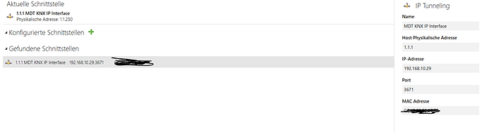

if I am not wrong, 1.1.1 is being used by the MDT interface
also, if the interface does not support multiple tunnels, don’t use ETS while OH2 is running
