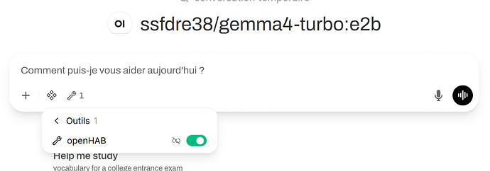

Part 5 — Connect MCP Server in Open WebUI
Follow these steps to register the openHAB tool server in the Open WebUI admin area:
Step 1: Open Open WebUI in your browser:
http://<your-host>:3000
Step 2: Log in as an admin user. If this is a fresh installation, the first registered
account becomes the admin.
Step 3: Click your profile icon in the bottom-left corner, then click Admin Panel.
Step 4: In the Admin Panel, navigate to SettingsTools.
Step 5: Click the + button to add a new tool server.
Step 6: In the URL field, enter:
http://localhost:8000
Leave the API key field empty (unless you configured one in mcpo).
Step 7: Click Save. Open WebUI will fetch the OpenAPI spec from mcpo and import all
tools automatically. You should see all openHAB tools listed.
Step 8: To use the tools in a chat, open a new conversation and:
  • Select a model that supports tool-calling (e.g. qwen2.5:14b)
  • Click the Tools icon (wrench symbol) in the chat input bar
  • Enable the openHAB tools from the list

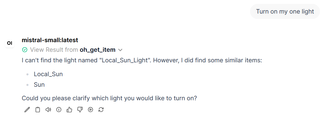

Step 9: Test with a prompt such as:
What is the current state of my lights in the living room?
The model should call the appropriate openHAB MCP tool and return the result.

I really don’t understand why mcpo is needed ?
1- openHAB already has a direct OpenAPI exposition. you should be able to connect directly from Open WebUI to it. Unless you really want to use the tool exposition created by openhab-mcp. But in this case…
2- …Open WebUI can also directly connect to a mcp server like the one defined in the OP, no need for an OpenAPI proxy like mcpo.
But as Rich mentionned, there is now an official MCP server integration in OpenHAB. You can completely bypass openhab-mcp and mcpo and connect directly Open WebUI to OpenHAB MCP. I use this and it works.

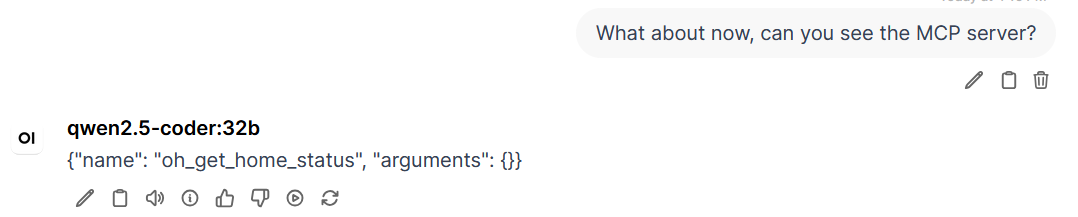

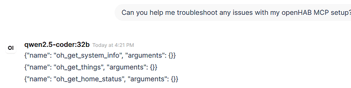

Ollama won’t execute OpenAPI tools or MCP tools. It is not a tool/MCP client. Its purpose is to “serve” a LLM endpoint.
You use a dedicated client, like Open WebUI, or a coding agent, for this. They “glue” the LLM with externality (like yourself, or others tools/services)
Firstly, what I mean by Ollama not executing tools, is this:
  1. in Open WebUI Admin Panel → Settings → Connections → under Ollama API there is the connection to my Ollama instance. A prompt for any model using this connection does not call the openhab-mcp tools
  2. in Open WebUI Admin Panel → Settings → Connections → under OpenAI API there is the connection to my llama.cpp instance. A prompt for a model using this connection does call the openhab-mcp tools
    Both Ollama and llama.cpp are serving the Llama 3.2 3B Instruct model (I’ve tried others as well, but this one is currently loaded in the llama.cpp instance). For me it is OK to just use the llama.cpp.
The second thing; indeed, sounds like the MCP add-on + MCPO is not needed as an OpenAPI compatible API is already available in openHAB :thinking: but for the sake of AI and MCP - indeed too, Open WebUI can connect to MCP servers natively! The documentation is outdated (tries to lead to External tools page that does not exist) and the UI is misleading at least to me (it mentions OpenAPI only). The trick is to go to Admin Panel → Settings → Integrations → click the + sign at External Tool Servers → click “OpenAPI” to change the type → fill the URL (ex. 127.0.0.1:8080/mcp) and Bearer API Key (the token). I did not realize that the type could be changed by clicking the “OpenAPI” label :thinking:
I’ll add that I tried to get Open WebUI to “talk to” the official MCP add-on yesterday, and failed. I must say that the way you configure these things in Open WebUI is some of the most messy thing I’ve ever seen. It’s really, really confusing, and the permission/access setting is especially so.
But, I think there are some pretty basic bugs in the MCP add-on as well. I ended up trying to use Postman to query the MCP add-on directly, because nothing would happen in Open WebUI (the MCP would show as “green” but be unavailable for use in chat sessions).
I tried several JSONs, and they all got the same response. Here is one of the request JSONs I sent:

This looks pretty broken to me, even if the request is invalid in some way, why convert a whole stack trace to JSON and dump that as a response? And, why require that the Accept header is two things at once?
I can partially confirm your observation with Open WebUI.
  • Using a good/large external model with an OpenAI API, when asking “List all tools you have access to”, I get a good listing of the tools available, including all OpenHAB MCP tools.
  • When using an ollama model, the same request give me really bad results.
I think that the model size / quality is the culprit here. I tested several ollama models and they give me very different results. It could be tied to the context size, or that the tool calling precision drops when too many tools are available.
For example, when Open WebUI internal tools are enabled:
  • the best ollama models I can use shows me one or two OpenHAB MCP tools, and pretty much every internal Open WebUI tools.
  • llama 3.2:3b is so bad that I can hardly have one tool listed, usually one of the Open WebUI internal one.
When Open WebUI internal tools are disabled:
  • the best ollama models I can use shows me several OpenHAB MCP tools.
  • llama 3.2:3b shows me, sometimes, an openHAB one. Or fails miserabily.
I think that the model capability is the culprit, but the fact that you got better result with llama.cpp with the same model is really confusing.
BTW, if you can run it, I strongly encourage you to test the ollama model ssfdre38/gemma4-turbo:e2b (but you MUST disable thinking if you don’t want to wait). Results are pretty good and fast for a model this size. I use it with the HLI provided by the beta/marketplace ChatGPT binding, linked to OpenWebUI API as an intermediary (to disable thinking). Tool calling with speed is HARD for small models, and the gemma 4 model is the first one I try which is able to do it reliably. I get less than two seconds delay when asking to light a bulb (I use a very old RTX 1060)
I couldn’t agree more…
Did you activate it in the chat session ?
I never found it, possibly because of their “unique UIX”, but I managed to find and enable it now.
Now I have that other issue that I’ve had before, where there is some miscommunication between Open WebUI and Qwen, so that it just answers by sending JSONs. I don’t know exactly what it’s about, but I’ve experiences in the past that it can “suddenly fix itself” and it starts outputting actualy replies. The whole thing is very much “experimental” I would say:
This is just immensely useful, but I don’t think it’s related to OH or the MCP, but some communication issue between Open WebUI and Qwen, as I’ve had that happen before without the MCP being involved. I guess I’ll have to try another model, because I can’t figure out why it happens:
Tool calling with a LLM is completely a demonic hack. (demonic as “how the hell can something like this really work at all??”). But a hack that can do incredible thing nonetheless.
Many small models mess this up, and do not put the correct JSON markup to do ‘proper’ tool calling. Then JSON garbage ends up in the conversation, like the one you get. But it’s surprising, because the qwen model you use (32b) should be pretty good at this.
It’s the “beauty” of the things, there is nothing to understand :rofl:. The LLM just fails and outputs garbage.

To get a more capable model that isn’t Qwen, I’ve downloaded mistral-small. It, too, can talk to the MCP, but I’m wondering if it has something of a “God complex”:
I really hope I don’t accidentally make it turn off the sun!
The usual “AI slop” is prevalent. I asked it a stupid question, but it was one of the “suggested follow-ups”.
Is there a way to automatically restart or reconnect these offline devices?
The answer is that there’s nothing it can do to reconnect these, most of them don’t even exist (they are just Things used in previous tests). But, instead, it goes on providing utter BS suggestions:
