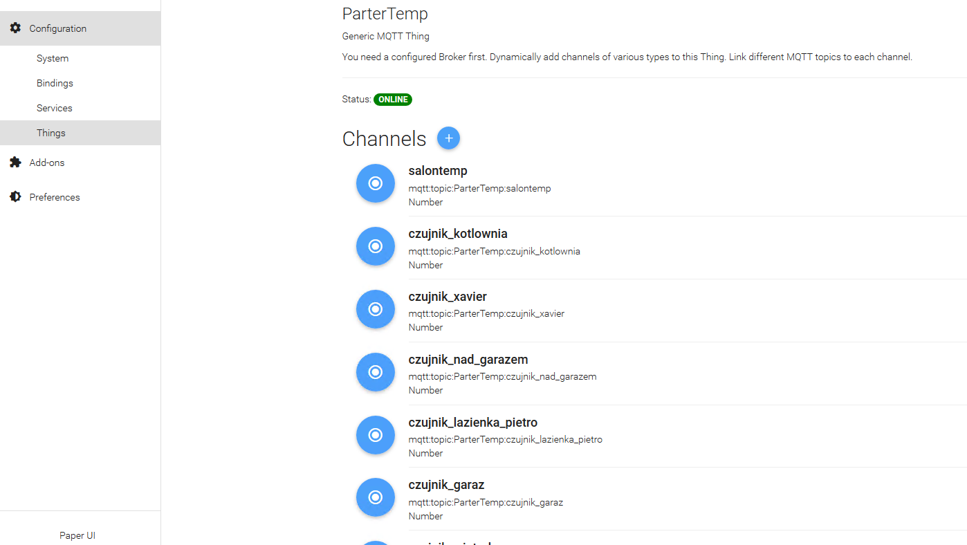

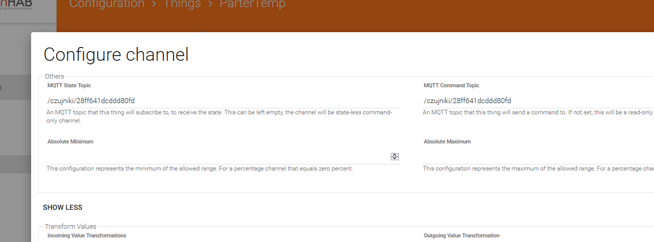

So in Paper UI
Configuration/Thins/Temp i have
sensor_room/ mqtt:topic:sensor_room
that is, the item should look like
Number sensor_room “room Temperature” {channel=“mqtt:topic:sensor_room”}

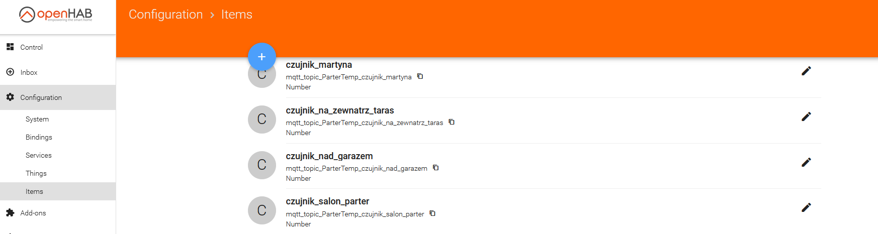

If you click on the blue circle of your mqtt channel ( for example “salontemp”) the linked item name will be shown! You can use this item-name in the.persist file.
The problem is the simple mode, I guess.
As far as I know the item names aren’t shown then.
@Martin_Rudowicz1:Try disabling the simple mode as explained here and then you also see the items in the navigation on the left side.
Ups, I didn’t know that one! Thanks for stepping iun.
I change Simple mode ande now i see item

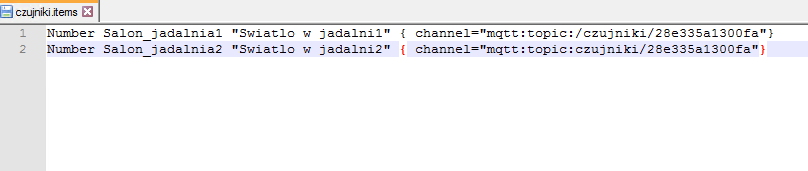

I would not expect Items Salon_jadalnia1 and 2 to be persisted, as I would guess they never get a value. The channel links you defined in your czujniki.items file are invalid.

These are definitions for completely different Items named Salon_jadalnia1 and Salon_jadalnia2
I do not think they will work, because the channel definitions look faulty to me.
I expect that means they never get updated to sensible values.
Can you see them getting updated in your events.log?
If they do not get updated to sensible values, then are no sensible values to be persisted, and these Items will not be persisted.
