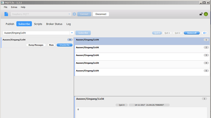

I let show me by MQTT my temperature and humidity of the living room.
Switches via MQTT work also.
But I have problems, when my Sunset Rule switches my switch item to ON, then unfortunately nothing happens via MQTT. But if I switch the switch in the sitemap by hand to ON or OFF, then MQTT is the right one.
I hope you can help me with my problem.
My items
DateTime SunsetStart_Time "Sunset Start [%1$tH:%1$tM]" { channel="astro:sun:local:set#end" }
Switch SunsetStart "Sunset Event" {mqtt=">[mosquitto:Aussen/Eingang/Licht:command:ON:1],>[mosquitto:Aussen/Eingang/Licht:command:OFF:0],<[mosquitto:Aussen/Eingang/Licht:state:MAP(binary.map)]", autoupdate="false"}
My rule
rule "SunsetNeu"
    Time cron "0 * * * * ?"
    val dtSunset = new DateTime(SunsetStart_Time.state.toString)
    val iTimerSunsetStunde = TimerSunsetStunde.state as DecimalType
    val iTimerSunsetMinute = TimerSunsetMinute.state as DecimalType
    val iMinuteCurrent = now.getMinuteOfDay
    val iMinuteSunset = dtSunset.getMinuteOfDay
    val iMinuteTimer = iTimerSunsetStunde.intValue * 60 + iTimerSunsetMinute.intValue
    if ((iMinuteCurrent >= iMinuteSunset) && (iMinuteCurrent < iMinuteTimer))
        logInfo("SunsetNeu", "Lichter eingeschaltet")
        postUpdate(SunsetStart, ON)
    else
        logInfo("SunsetNeu", "Lichter ausgeschaltet")
        postUpdate(SunsetStart, OFF)

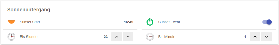

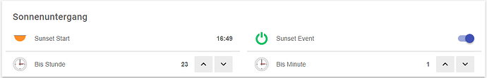

My sitemap
	Frame label="Sonnenuntergang"{
		Text item=SunsetStart_Time icon="sunset"
		Switch item=SunsetStart icon="switch"
		Setpoint item=TimerSunsetStunde	icon="clock"   minValue=0 maxValue=23 step=1
		Setpoint item=TimerSunsetMinute	icon="clock"   minValue=0 maxValue=59 step=1
Sitemap:

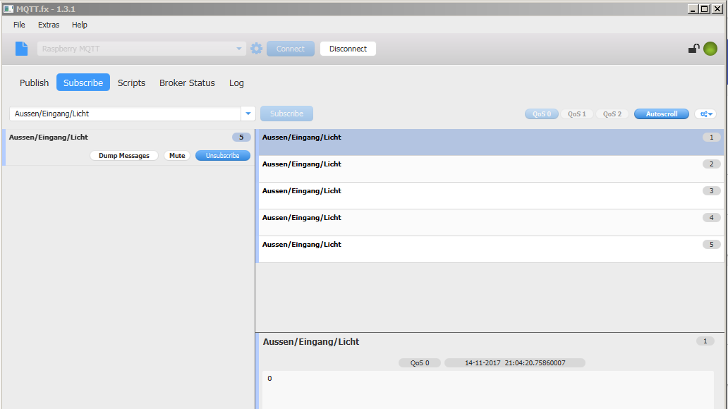

MQTT:
(The events in the MQTT image come only when I switch the switch in the sitemap)
I could solve the problem by myself.
The error is in the
command.
The command
sendCommand(SunsetStart, ON)
has solved the problem and mosquitto now receives the messages.
