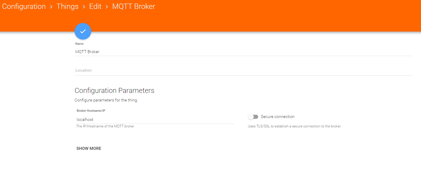

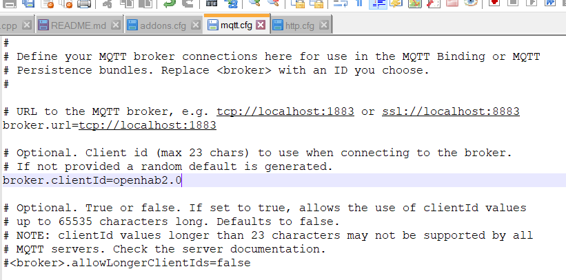

I saw some tutorials with MQTT and openHAB, i create an mqtt broker step by step and my broker appear offline and i don’t know why, any idea?
Can you show me the openHAB configuration for the MQTT binding and the broker.
I have installed MQTT Binding 2.4.0
If you have an example of MQTT or HTTP or REST can I have it? I have programming skills but i have problem with those examples :frowning:
I don’t see anything about your MQTT binding and Things definition. Have you installed/configured the MQTT Binding as well or just the broker? You’ll need the binding too and create a Thing in OH with channels that represent the topics to have the ESP8266 subscribe to and publish it’s temperature data and whatever else you want to publish to MQTT. You can find more info here and here.
