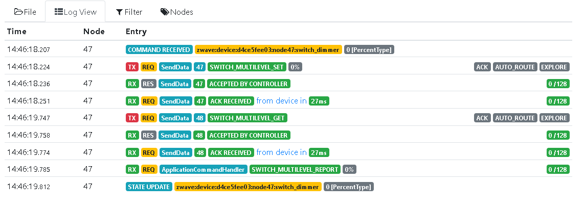

When I went to debug this I was expecting something that looks like the following screen shot in the zwave logs which shows (1) Command Received [by the binding I think] (2) Command Sent out “Tx” (3) Ack from the device “Rx” (4) Then a GET to see the state of the device.

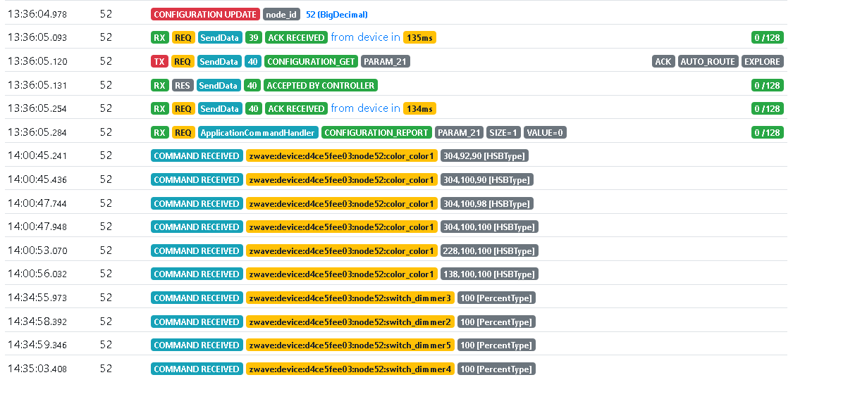

I did try to change the configuration parameters - They were successfully updated (Communication to/from the ZEN31 seems to work for this). You can see this in the logs below. The reason I think this is an OpenHAB issue is because it seems like the Binding receives the command to update Color or Red/Green/White/Blue Levels (i tested all of them) but then doesn’t actually do the “Tx” out the ZWave Radio.

I agree the node47 is exactly what is supposed to happen and that with the param 21 change there is reasonable communication.
The only thing that led me to param 150 was the RGBW / HSB Wall Switch Mode title and “0” is the RGBW option and the commands not going out are HSBType. I’m going to have to do some research.
