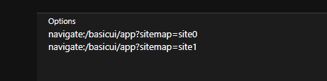

i created an item “site0” , with indeed meta dat options like below
but then what? how can this be controlled to browse to other sitemap(s) ? , its a bit confusing

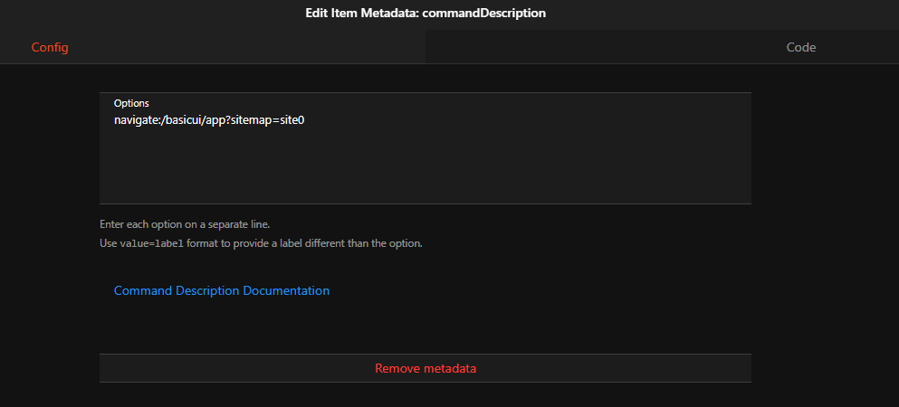

ok, so i create an String item first called “switchsitemap”, defined with 2 command options:
On my android app, i enabled the “UI setting”, named the field also “switchsitemap”

Sorry for the confusion. The command option is used when you use the main UI.
Problem here is that the ‘=’ used in the sitemap, is here interpreted as ‘label’. So it might not work ‘out of the box’. So you can delete this.

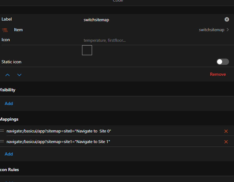

Like Rich is saying you need a mapping in the sitemap so you can chose between. See here:

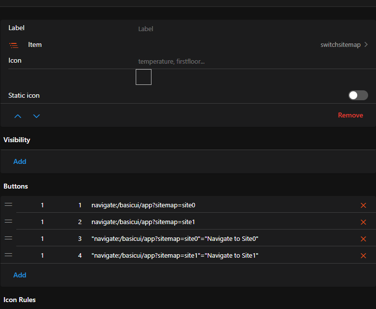

indeed, its partially working, instead of an switch element, i added a button grid for test, with 4 buttons like below, but indeed i struggle with the =
the first 2 buttons always navigate to site0
the 3th and 4th button dont do anything, they are also labeled strange like site0" and site1"
not sure how i can fix that ? i need the “=” since its part of the url (navigate) ?
Yes, this is the address like it is also shown in in the browser (url).

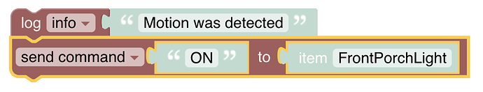

The workaround would be to make a rule (blockly) where you can send the command sting directly to your “switchsitemap” item. Like a statemachine. For example you create a number item.
Depending on the state of your numer item you send the command string to your “switchsitemap” item.
But this is just an idea…

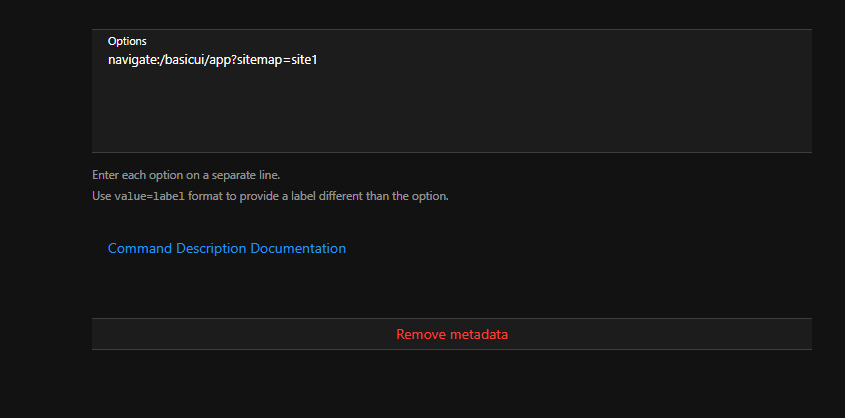

but for test, i now edited my “string” UI item, with just 1 command, even that fails because of the “=” between it… for test i used site1 … when pressing the button , it just takes the default sitemap, in my case “site0” …
so your workaround is probably also not going to work? i cant even define a correct string item with the correct command options?

hmm, seems quite hard to send an “=” , ok, then i try the blockly approach …

Try escaping the = with a \. ...app?sitemap\=site1
It also might work if you URL encode the equals. ...app?sitemap%3Dsite1
I don’t use this feature so can’t say it will work but these are the first things I would try.
