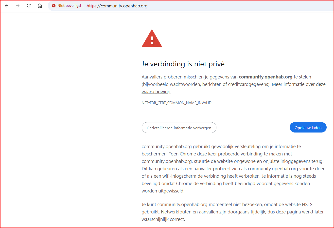

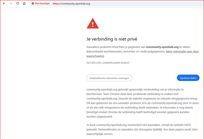

I’ve been using Pi-Hole for a long time, but since today, the access to openhab.org is blocked:
The error code is net::ERR_CERT_COMMON_NAME_INVALID. If I click the error code, it shows two long certificates, but I never know how sensitive they are, so I decided not to paste them here.

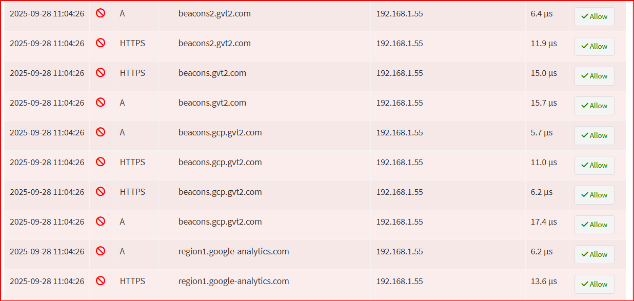

Checking Pi-Hole’s log, these seem the addresses it blocked:
But I verified: it blocked these addresses yesterday as well, and yesterday I had no problem accessing openhab.org…

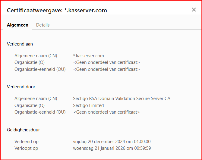

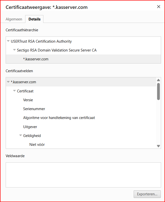

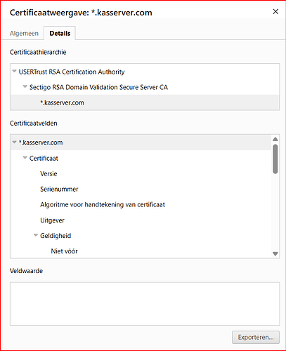

This is the “certificate information” Google Chrome provides:
Does anyone have any idea what happened? I know I can unblock the above mentioned domains, but the seem to be the kind of domains one would like blocked…
(I also tried deleting all cookies, but no effect.)
The server certificates presented to your browser by the server can be shared, as everyone connecting to the server can see them, there is nothing to hide.
To me, it seems the block and the error are not related, though I don’t understand Dutch :wink:
I don’t know what Pi Hole does when blocking a domain, but I’d think it returns an invalid IP not pointing to any server (like AdGuard Home does).
The security error though indicates that openhab.org is resolved to someone else than openhab.org, and that someone else can’t present a valid certificate for openhab.org.
Can you please share the certificates?
And please share what nslookup openhab.org returns.

This is the text that appeared when I clicked the error code:
Subject: *.kasserver.com
Issuer: Sectigo RSA Domain Validation Secure Server CA
Expires on: 21 jan 2026
Current date: 28 sep 2025
PEM encoded chain:
