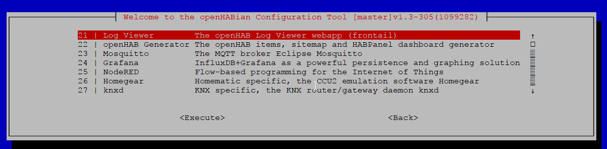

If you are running openHABian, you should enable frontail, if not already done.
sudo openhabian-config
Afterwards you can review the openHAB logs with pointing your browser to
http://<ip-of-pi>:9001
Then you can track down the problem.
