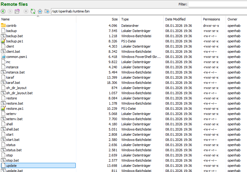

Should be in runtime/bin/:
update

It should be in runtime/bin.

An update file is also in a manual linux installation and it works fine.
I started using it with 5.x. and had no problems so far.
It updates the version and it checks my jsondb.

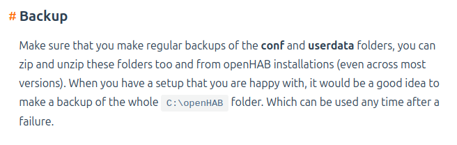

Someone should also fix the windows docs because they are definately lying to me:
The Linux docs for manual installation tell you how to upgrade manual unstallations:
From version 2.1.0, openHAB is distributed with the update script included. This script should be called from within openHAB’s root directory. Assuming the openHAB directory is in /opt/openhab, simply run the following commands to update to the next major version of openHAB:
cd /opt/openhab
sudo runtime/bin/update
(openHAB on Linux | openHAB)
This update script also runs the upgradetool: openhab-distro/distributions/openhab/src/main/resources/bin/update at c603838d425e8ed83501f2d871a9922474da9f2d · openhab/openhab-distro · GitHub
If you copy data from installation A to installation B and B is newer you are doing an upgrade, you just keep the old version in place. => You need to run the update script.
There’s an “Edit this page on GitHub” button down below that page …
