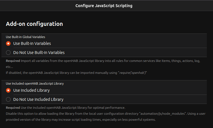

However, I also seem to have found a “solution”, and that is adding in the following at the top of the Rule file
const { time } = require('openhab');
Problem is, that I don’t see this in the examples, and trying to follow the code (My rule file->timerMgr.js->helpers.js) I have no clue as to why it was failing nor why my ‘fix’ is working, other than maybe I was picking up a different java ‘time’ library perhaps?
Any ideas/thoughts welcome.

JS Scripting Config is as follows:
