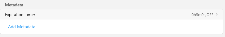

There’s a more elegant solution to this: using “expire”, so you can define on an item, what should happen to a specific time after the last value change.
in OH3 you can do this also conveniently within the GUI. Go to the item, click on “Add Metadata” and “Expiration timer”. There you can chose, what should happen after a specific period of time.
As I said, the more elegant solution would be to work with the “Expiration”-Metadata.
