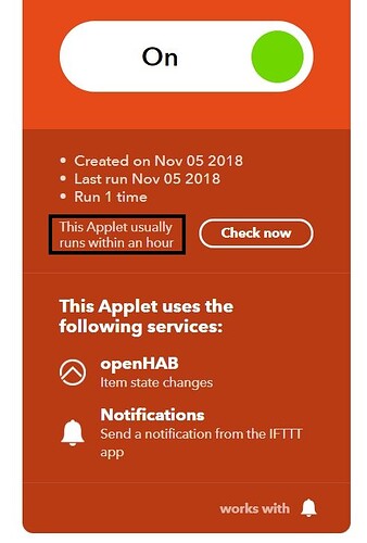

Does someone know why the IFTTT recipe would take an hour to send a notification? Can we speed it up?
The real goal of it is not to send a notification but to turn on a light connected via wifi which as a IFTTT channel. It would be the easiest way to do so, but an hour to turn on a light is not acceptable
I´m currently having the same issues.
I wanted to change the Motion Detection of some cameras that only support IFTTT.
The current way is: openHAB → myopenhab → IFTTT → Camera
I noticed that the IFTTT applet runs an hour after the item changed in openHAB.
This isn´t nice but ok when leaving, but it´s not ok when coming back and the cameras are still online to record when motion is detected.

Did you get anywhere with the webhooks way?
Did it speed up the applet running?
Was there any changes to the original rule with it now being webhooks v the old maker
I want to do the same for my camera / presence detection for exactly the same reason, the myopenhab cloud link makes the applet run within an hour which is far to many motion detection notices on my phone for it to be acceptable.
Yes and yes.
I´m using the webhooks and it works almost without a delay.
I build a total of 6 webhooks for my two cameras.
Both ON/OFF, Camera1 ON/OFF, Camera2 ON/OFF
Great, that’s the answer I hoped you would give…sound perfect for what I’m after.
Did you have to change much of the code in the first post to work with webhooks rather than the old maker or have IFTTT effectively just changed the name?

EDIT 2 > The applet is now running seconds after the webhook rule runs rather than the ‘within an hour’ using the OH applet…problem so far solved!
