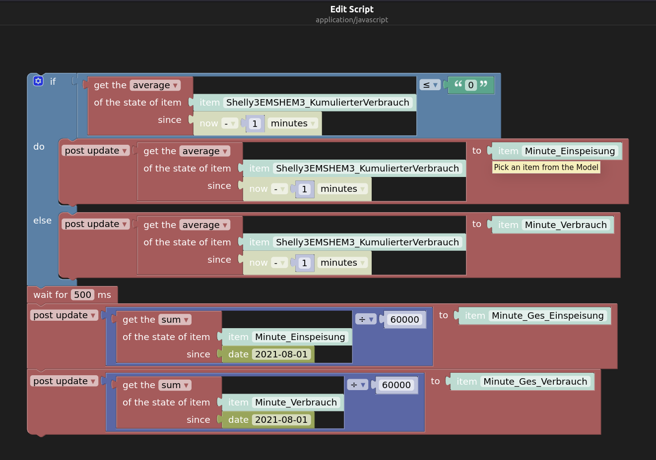

It is more than a code…and it is a little complicated…
Bute the answer is here:
https://discourse.openhab.org/t/blockly-or-script-how-to-get-sum-of-item-since-now-to-date/134217/27

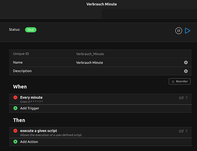

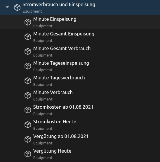

First you need 10 Items:
You must change your persistence service to JDBC.
Then make a file for JDBC:
jdbc.persist:
Strategies {
everyMinute : "0 * * * * ?"
everyHour : "0 0 * * * ?"
everyDay : "0 0 0 * * ?"
default = everyChange
Items {
Shelly3EMSHEM3_KumulierterVerbrauch : strategy = everyChange, everyMinute, everyDay, restoreOnStartup
Minute_Einspeisung : strategy = everyChange, restoreOnStartup
Minute_Verbrauch : strategy = everyChange, restoreOnStartup
Minute_Ges_Einspeisung : strategy = everyChange, restoreOnStartup
Minute_Ges_Verbrauch : strategy = everyChange, restoreOnStartup
Minute_Tageseinspeisung : strategy = everyChange, restoreOnStartup
Minute_Tagesverbrauch1 : strategy = everyChange, restoreOnStartup
Stromkosten_Summe : strategy = everyChange, restoreOnStartup
Stromkosten_Tag : strategy = everyChange, restoreOnStartup
Einspeisung_Summe : strategy = everyChange, restoreOnStartup
Einspeisung_Tag : strategy = everyChange, restoreOnStartup```

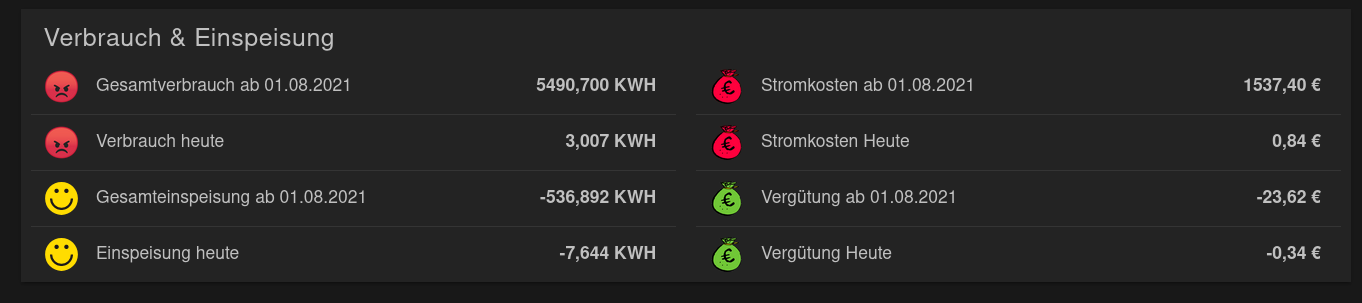

home.sitemap:
Frame label="Verbrauch & Einspeisung" {
Text label="Übersicht" icon="energy" {
Text item=Minute_Ges_Verbrauch label="Gesamtverbrauch ab 01.08.2021 [%.3f KWH]" icon="boese"
Text item=Stromkosten_Summe icon="money_red"
Text item=Minute_Tagesverbrauch1 label="Verbrauch heute [%.3f KWH]" icon="boese"
Text item=Stromkosten_Tag icon="money_red"
Text item=Minute_Ges_Einspeisung label="Gesamteinspeisung ab 01.08.2021 [%.3f KWH]" icon="smiley"
Text item=Einspeisung_Summe icon="money"
Text item=Minute_Tageseinspeisung label="Einspeisung heute [%.3f KWH]" icon="smiley"
Text item=Einspeisung_Tag icon="money"

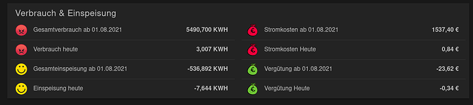

Then it look like this:

How does the blockly Script with Rule DSL ?
Would this also possible?
