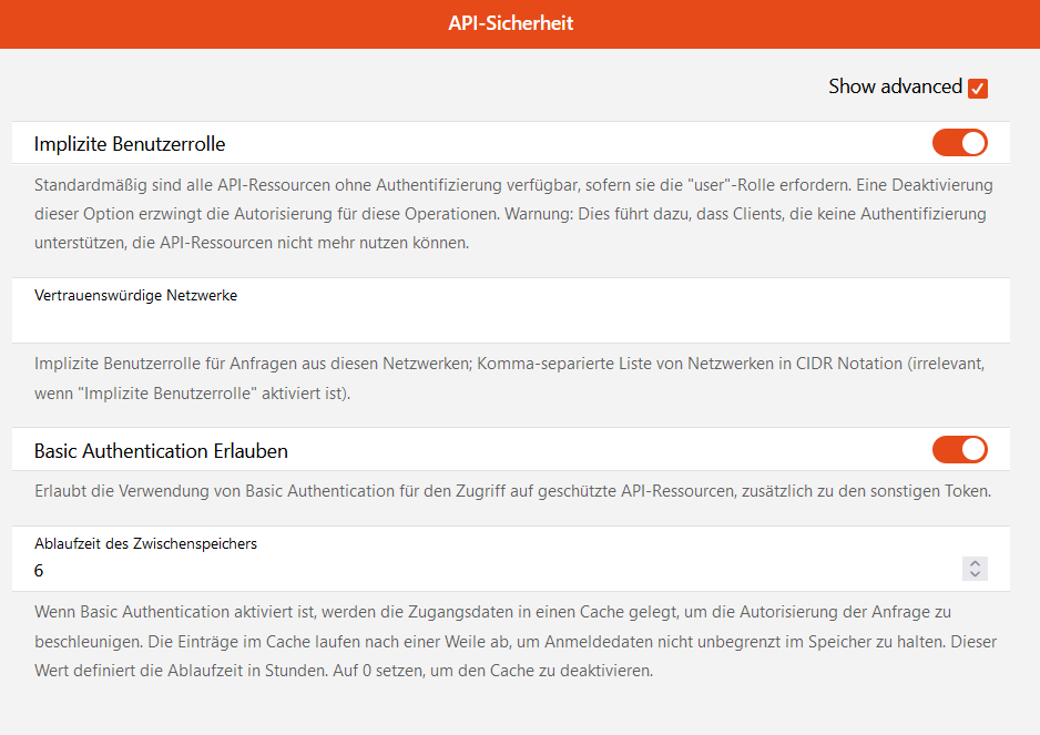

The following is configured for the REST API:

Thanks for the detailed information. We found an issue with the Cloud Connector login page which didn’t redirect back to the original requested url. Basically after you signed in, you should have gotten an OAuth2 authorization page for the Alexa skill.
Anyway, a fix have been released to myopenhab.org. You should now be able to complete the skill account linking process. Once you accept the OAuth2 authorization, it should go back to the Alexa app confirming that the skill is enabled and linked.
