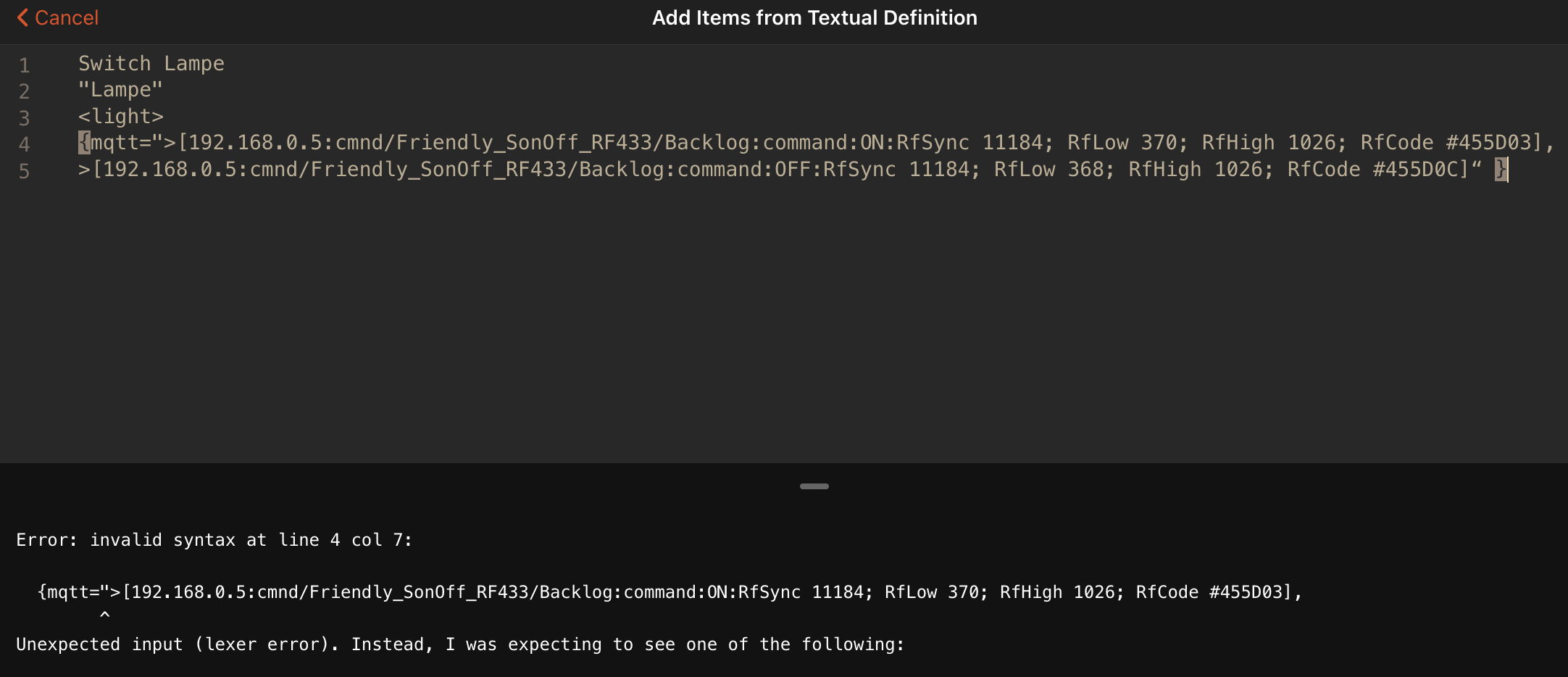

Most of the steps you explained I already have successfully done:
I am stuck at:
What I need to learn is the syntax and the exact commands to send. This is where I need a little push into the right direction. I will try to read more about this and hope I get this sorted in my little old brain.

This is part of a MQTT .things file that I use. It may give you an idea of the syntax to create the thing. This thing is one of the Sonoff S31 power switches that I use for Christmas tree lights. Your channels and topics will need to match the requirements for your device.
Bridge mqtt:broker:MqttBroker [
host="10.0.0.100,
port="1883",
secure=false,
username="OptionalMqttUserid", password="OptionalMqttPassword",
clientID="OpenHab"]
Thing topic ChristmasTreeThingId "ChristmasTree" {
Channels:
Type switch : power "Power" [stateTopic="ChristmasTree/stat/POWER", commandTopic="ChristmasTree/cmnd/POWER"]
Type string : sleepmode "Sleep Mode" [stateTopic="ChristmasTree/tele/STATE",transformationPattern="JSONPATH:$.SleepMode"]
Type number : sleep "sleep" [stateTopic="ChristmasTree/tele/STATE",transformationPattern="JSONPATH:$.Sleep"]
Type number : loadavg "Load Average" [stateTopic="ChristmasTree/tele/STATE",transformationPattern="JSONPATH:$.LoadAvg"]
Type number : wifiap "WiFi" [stateTopic="ChristmasTree/tele/STATE",transformationPattern="JSONPATH:$.Wifi.AP"]
Type string : wifissid "SSID" [stateTopic="ChristmasTree/tele/STATE",transformationPattern="JSONPATH:$.Wifi.SSId"]
Type string : wifibssid "BSSID" [stateTopic="ChristmasTree/tele/STATE",transformationPattern="JSONPATH:$.Wifi.BSSId"]
Type number : wifichannel "Channel" [stateTopic="ChristmasTree/tele/STATE",transformationPattern="JSONPATH:$.Wifi.Channel"]
Type number : wifirssi "RSSI" [stateTopic="ChristmasTree/tele/STATE",transformationPattern="JSONPATH:$.Wifi.RSSI"]
This associated Items file is
Switch ChristmasTree "ChristmasTree [%s]" {channel="mqtt:topic:MqttBroker:ChristmasTreeThingId:power"}
String ChristmasTreeSleepMode "ChristmasTree Sleep Mode [%s]" {channel="mqtt:topic:MqttBroker:ChristmasTreeThingId:sleepmode"}
Number ChristmasTreeSleep "ChristmasTree Sleep [%d]" {channel="mqtt:topic:MqttBroker:ChristmasTreeThingId:sleep"}
Number ChristmasTreeLoadAvg "ChristmasTree Load Average [%d]" {channel="mqtt:topic:MqttBroker:ChristmasTreeThingId:loadavg"}
Number ChristmasTreeWifiAP "ChristmasTree AP [%d]" {channel="mqtt:topic:MqttBroker:ChristmasTreeThingId:wifiap"}
String ChristmasTreeWifiSSID "ChristmasTree SSID [%s]" {channel="mqtt:topic:MqttBroker:ChristmasTreeThingId:wifissid"}
String ChristmasTreeWifiBSSID "ChristmasTree BSSID [%s]" {channel="mqtt:topic:MqttBroker:ChristmasTreeThingId:wifibssid"}
Number ChristmasTreeWifiChannel "ChristmasTree Channel [%d]" {channel="mqtt:topic:MqttBroker:ChristmasTreeThingId:wifichannel"}
Number ChristmasTreeWifiRssi "ChristmasTree RSSI [%d]" {channel="mqtt:topic:MqttBroker:ChristmasTreeThingId:wifirssi"}
Adding Things - Advanced | openHAB shows all the steps for all of these through the UI. I don’t do .things files so if that’s your thing hopefully you can find some examples on the forum or some other help. I consider it a waste of time to fight syntax errors when I can be fighting home automation errors instead.
