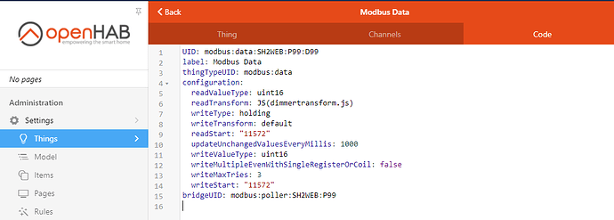

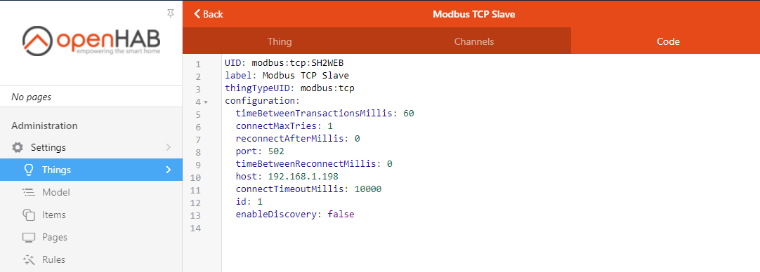

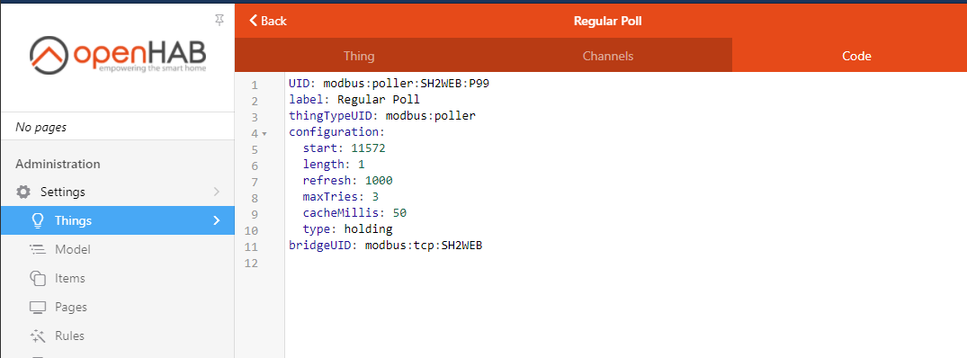

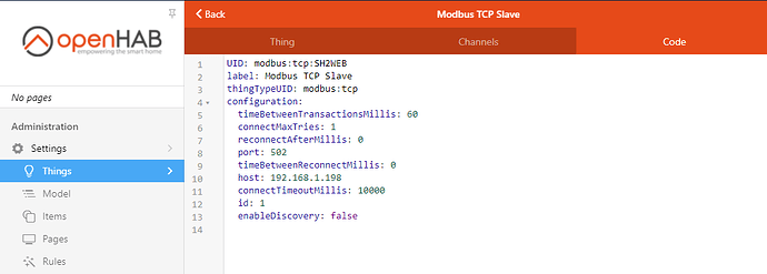

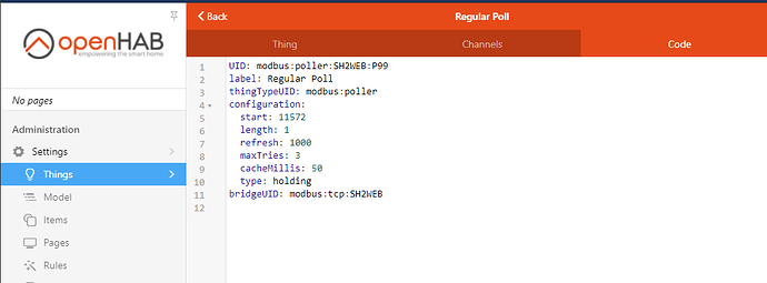

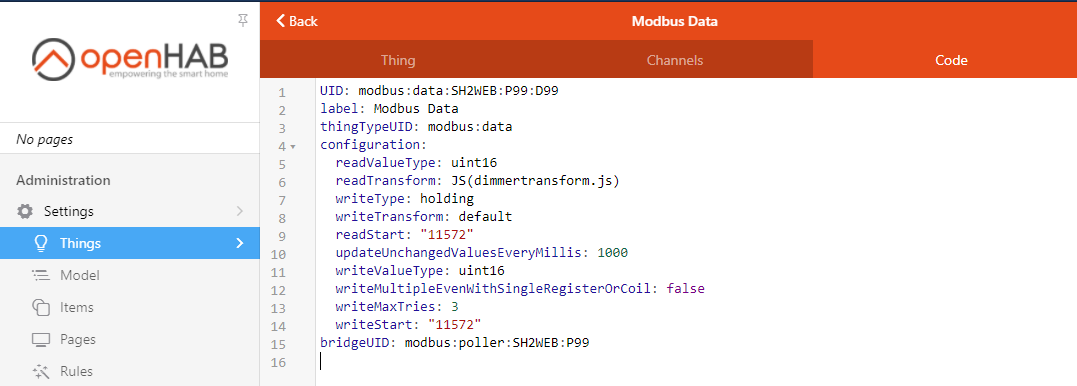

I am reviving this old topic because I have identical Carlo Gavazzi hardware as the first poster, but I can’t seem to get my CG modbus dimmers to work. Tried with Per’s suggestion, but nothing. Also looked at this one: Use Dimmer-item with modbus binding OH2
I am quite new to OH, but I have configured the modbus tcp slave, regular poll and the modbus data. If I configure the dimmer as “value as switch” I get the light to turn on/off, so I know all the communication/adresse and so on is correct. All this through Paper UI.
I believe the fault is in the transformation? I have installed the JS trans add-on and created the transformation “trick” file in $OPENHAB_CONF/transform. Is that the correct location?

But looking at your picture I find the same info from the paper UI.

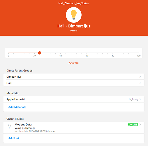

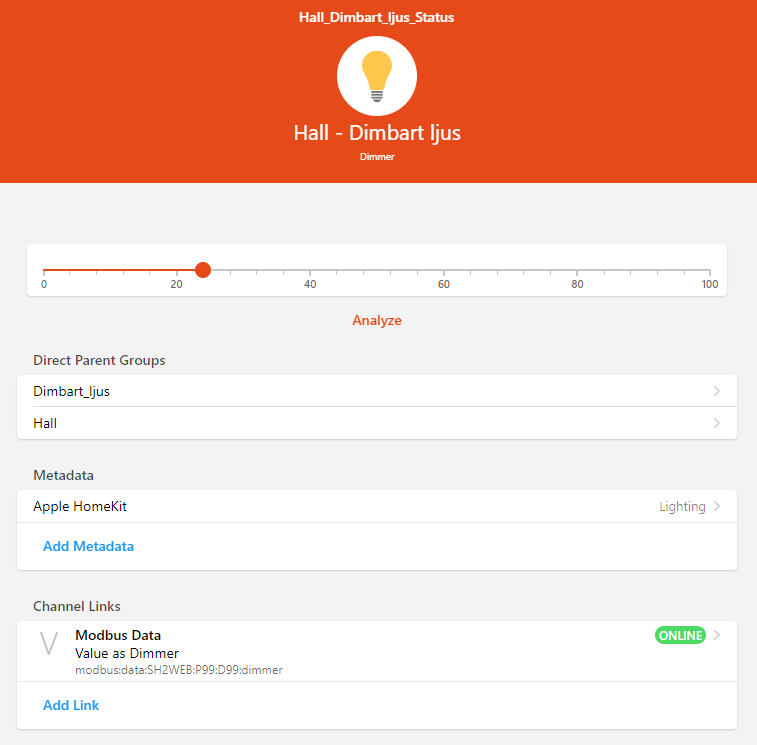

Can these pictures from one of my dimmers help you?
Thanks alot @Pe_Man
I have now set up it up exactly like yours, but unfortunately still nothing.
Can you check if your transform file is located in /etc/openhab/transform?
[19:38:16] openhabian@openHABianPi:~$ cat /etc/openhab/transform/dimmertransform.js
(function (inputData) {
return inputData;
})(input)
Have you also an item linked to the correct channel?
How do you “write” to the dimmer? with rules, CLI, paper UI or what?
Thanks alot. I have some progress now: it is dimming. Can you post your “slider” conf for the sitemap also?
I removed my old slider and created a new one, and added min level 0 and max 10 in paper ui. The scale is now wrong, but it is kind of working.

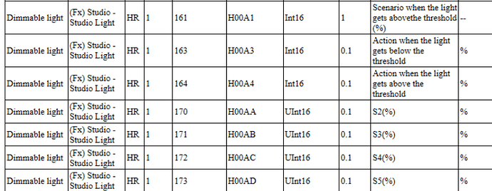

If you make a sequence in the SH Tool, and add a dimmer you’ll see tha you can set I think 0-9 to the dimmer meaning different preset levels. I guess these values are the ones you should write as modbus value also to achieve the same levels.
Yes, you are correct. Sx tool manual states this:
It also states this and a lot of other interesting stuff. Also some modbus maps in the old ctrl_x manual. Will search around and find something that works.
