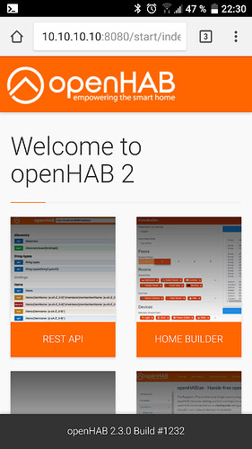

Try to upgrade to the lastest snapshot Build #1231 , it solve the problem for me

The build# is shown in the bottom when you go to openHAB in your browser.

I found out my version is openHAB 2.3.0 Build #1203 .
