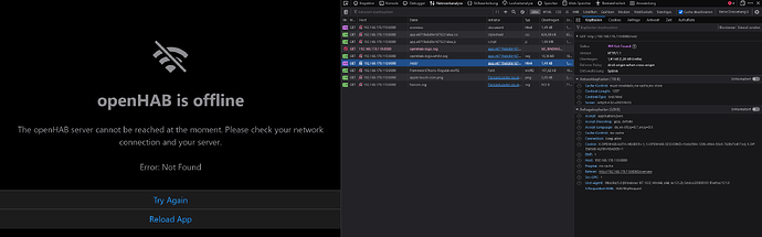

Hello Forum,
my OH is dead :frowning:
API 404
I updated to version 4.1.0 2 days ago.
Everything has worked well so far.
Now I felt like installing the suggested bindings.
I tried to install the Android TV binding and UPnP.
Both seem to have gone completely wrong.
I didn’t do anything on the side during the installation and gave the system ~10 minutes for the installation.
Now openHAB starts, but the UI crashes after about 1-2 minutes.
The API interface is completely offline, other parts still seem to work in the background, which I can see in the log.
I have already cleared the cache and restarted the entire system several times.
Unfortunately, the UI still crashes.

The marketplace folder did not contain any of these bindings either.
It only contained the binding for the Signal app and a Yamaha AV, which had previously worked.
After the restart, the folder has not yet been recreated.
But that’s a completely different message. Can you try list and check if any add-ons are installed? Are all bundles shown in Active state?
Sure. Here is the list:

In general does not look bad. I wonder why there are so many bundles in “Resolved” state. Is that the first start after you deleted the marketplace folder? If so, please re-start. If not, try to start some of the bundles start <bundleId>. The bundle id is the number in the first column.
Yes, I restarted OH after deleting it.
I stop OH, deletee the folder, start OH.
I also cleared the cache again after deleting.
After two more restarts, OH seems to have recovered.
Currently, the UI has been accessible again for several minutes and there are no more error messages in the log.

OH won’t start with it.
It only works with Java17.
Update 2:
In my test VM with my backup, I was able to reproduce the problem.
I installed OH 4.1.0, imported the backup and restarted the server once.
OH starts without any problems.
A binding installed (e.g. AVM) → Broken.
2023-12-27 22:22:23.475 [WARN ] [apache.cxf.jaxrs.utils.ResourceUtils] - No resource methods have been found for resource class javax.ws.rs.core.Response
2023-12-27 22:22:23.476 [WARN ] [apache.cxf.jaxrs.utils.ResourceUtils] - No resource methods have been found for resource class javax.ws.rs.core.Response
2023-12-27 22:22:24.506 [WARN ] [rd.internal.AriesJaxrsServiceRuntime] - Application CachingServiceReference {
cachedProperties={osgi.jaxrs.application.select=null (cached), osgi.jaxrs.application.base=/api, service.id=2280, application.ready.service.filter=null (cached), objectClass=[javax.ws.rs.core.Application], service.scope=singleton, osgi.jaxrs.name=null (cached), osgi.jaxrs.extension.select=null (cached), osgi.http.whiteboard.context.select=null (cached), osgi.jaxrs.whiteboard.target=null (cached), service.bundleid=343}

Has nobody had the error yet?
Am I by chance the only one again?
Crap …
I might have to sit down and install openHAB from scratch :frowning:
If anyone has any good tips on this, please let me know.
