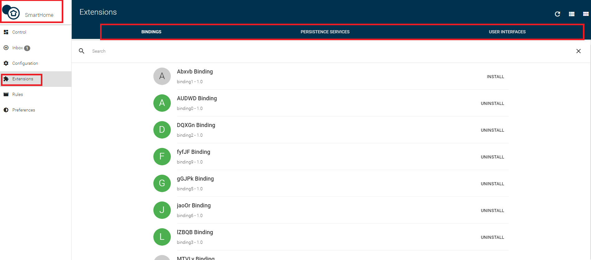

Issue of the topic: I have build openhab-distro source code. which is dowloaded from github
But UI page is look different then origional openhab page. see difference below

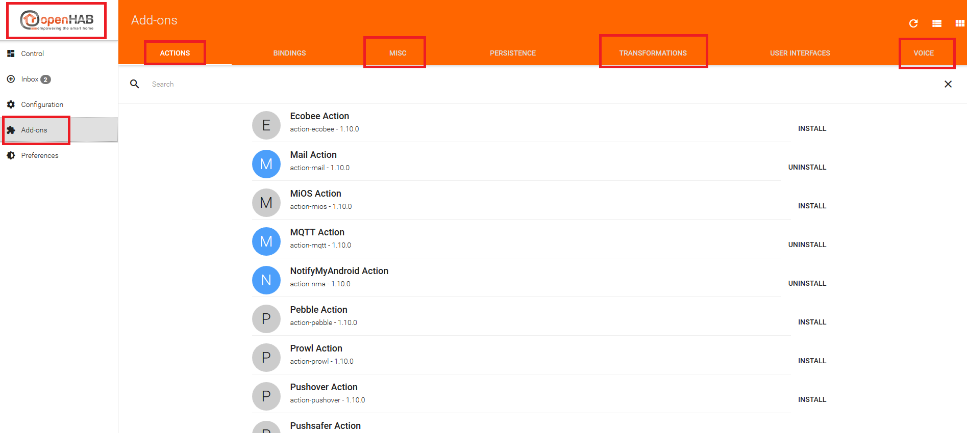

See all red circle differece. Why its build source ui is different then original ui page.
Looks as if the org.openhab.ui.paperui fragment is missing in your installation (or being installed too late).
This fragment brings the openHAB UI adaptions on the (otherwise ESH styled) Paper UI.
paperui is showing but after click on paperui , there is in another page which left side menu are not same like original ui.
