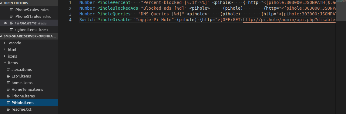

Now, you can now use you Designer and open/create files on that file share.
Create an item file in the items folder. Eg. enigma2.items (the name is not relevant. You can have multiple .item files. It is just for you to keep an overview what is where configured)
