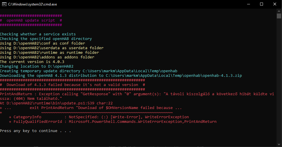

I tried to upgrade my openHAB version to 4.1.0 M3 , but the update.bat file always giving me this error. I dont know what to do. Does anyone had this issue?
Looks like you sre trying ti download 4.1.3 instead on 4.1.0.M3?
What command are yoh using to upgrade?

I follwed the installation as described on the openHAB page. The current version that I use is 4.0.3 I wanted to upgrate my system to 4.1.0 M3 with the update.bat file. I attached the picture from that one in the bigining. I tried with that command that you added and I always get an error for the path has been not founded (I replaced the C: with D: because that is my openhab path). I don’t what is the problem with the update… But if its so difficult maybe I will try another smart home program…
The update process makes use of a ps1 file (not a update.bat). I am not sure where you are finding update.bat? (You are running on Windows I assume?)

fyi @Miko_Mark the reason your first attempt failed is because you passed an update request with an invalid version (4.1.3) or no version at all and that is what it told you. It defaulted to the next likely increment of what you had install so it tried to go from 4.0.3 to 4.1.3 based on logic in the script. You can review the script for yourself can clearly see the behavior I mentioned.
Download of 4.1.3 failed because it is not a valid version
there is no version 4.1.3 like you requested so of course it failed to find a 4.1.3.zip file.
