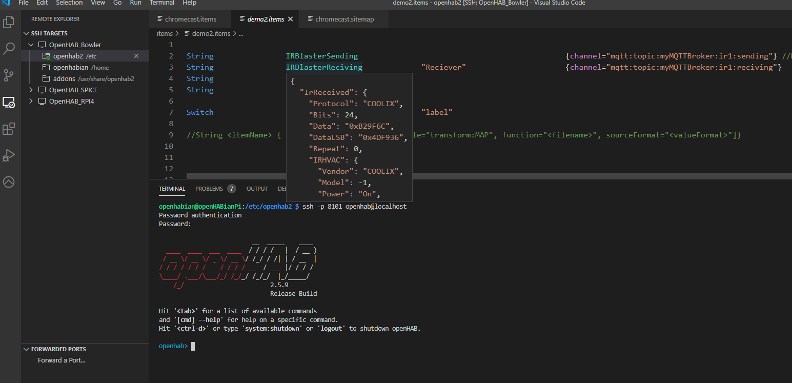

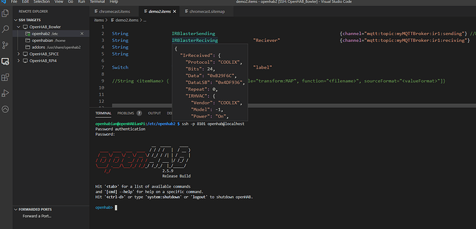

Hey @TomDidi,
Maybe this post from me can help you?!
It shows how to open the developer tools and check whats going on while hovering an item for example.
When hovering is working correct the console should display something similar to:
The corresponding items did show a valid hover in my case.
Maybe this helps or maybe you can then show us some error messages that show the behavior on your system.
Make sure to clean the log before testing with image because the console is quickly getting messy with many messages.
