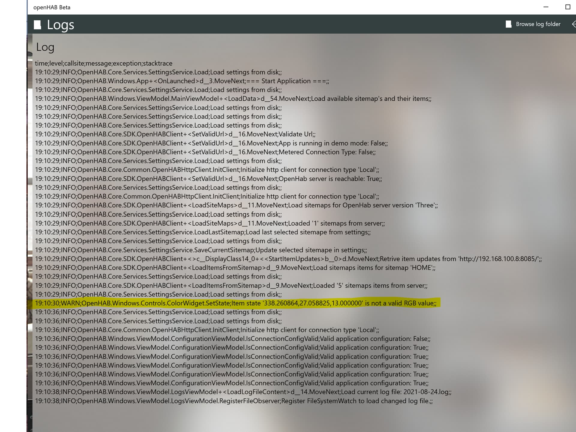

@elcosomalo Can you check the app log (Settings->View Log) if there is warning entry with the following text: “Item state ‘{rgbString}’ is not a valid RGB value”. It would be good to know what kind of values ({rgbString} is the placeholder for the value) the control tries to parse.
Yes sir, here is it:
Seems “338.260864,27.058825,13.000000” is not a valid RGB Value (0-255).
