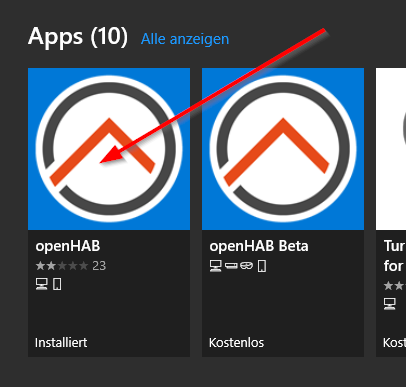

Hey All,
There is a new native Windows 10 Beta application, which provides upcoming features and fixes for testing before they will released in the major app.
