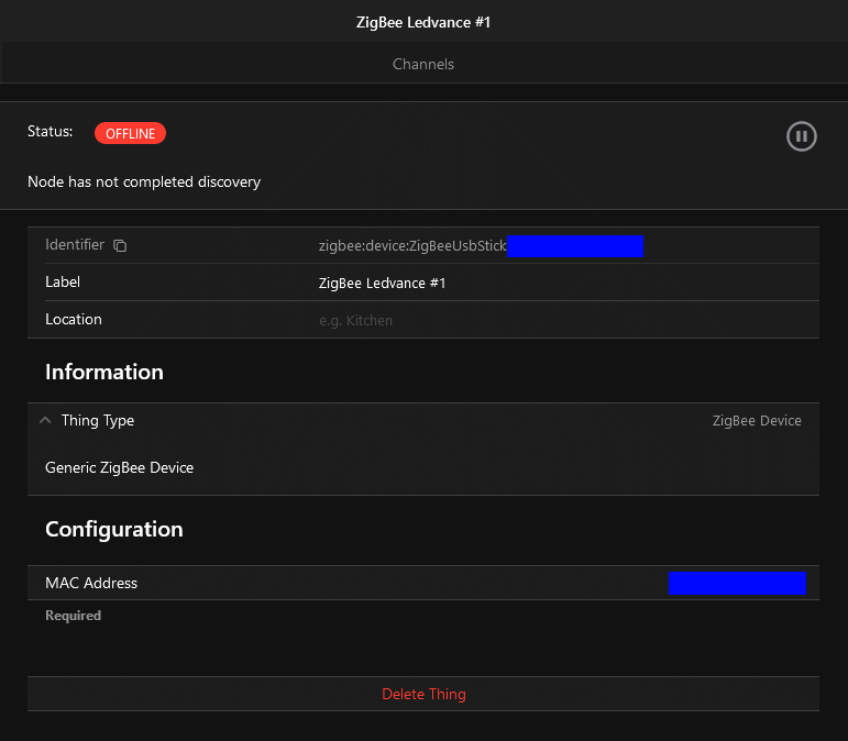

I bought a Philips Hue motion sensor and wanted to bind it to OpenHAB via ZigBee.
Unfortunately it didn’t work, because OpenHAB doesn’t find the device.
Additionally I have a few Ledvance sockets to connect here.
Time wise, my ZigBee stick broke. I guess the firmware on the stick shot it, so I had to buy a new one :frowning:
(Don’t have anything to flash here).
With a new stick, I now run into the same problems again.
  • Stick is recognized and mounted
  • After several changes of the config and about 20 restarts of the Raspberry Pi, the binding finally finds the devices again.
    => The setup is easy, scanning for devices is probably already a first big hurdle (Here the problem from 8 months ago: ZigBee (CC2531) + Tuya Switch - OH3)
  • Found devices can be created as Thing
The problem is that OpenHAB has no idea what kind of Zigbee-stick I’m using.
  • what kind of stick I am using
  • the connected devices are at all
Why?
OpenHAB creates XML configurations here: /var/lib/openhab/zigbee/zigbee_coordinator_cc2531_NAME.
I guess these are not filled in correctly.
Luckily I made a config backup of the last working state with my broken stick and have the old XML data on hand.
The new config it USB sticks looks like this:

However, the devices still do not work.
New devices, of which I have no XML-Config, are displayed in OpenHAB as “offline” with the reason “Node has not completed discovery”.
For devices for which I have a config, they are shown as online, but as soon as I try to change the value (e.g. turn on the light), they go offline.
I have this e.g. with the Philips Hue motion sensor and the Ledvance sockets.
How can I fix the whole thing again?
It’s slightly humble like that.
I’d like to keep it simple, which the ZigBee binding had managed quite well so far.
Zigbee2Mqtt I therefore do not want to do to myself.
Screenshot 2021-07-31 at 14-12-50 openHAB
