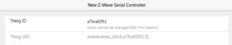

When you create and/or discover a Thing, it’s given a Unique Identifier (UID). Bridges and Things that do not work through a Bridge will use a randomly generated string as the UID.
Before you create that Thing though, you can change that UID to anything you want, so long as it’s unique. I recommend using something meaningful, like “controller” for a zwave controller.

- Delete the old Zwave controller Bridge Thing, taking note of the Thing UID.
- Manually create a new Zwave Bridge Thing. Before clicking “Create Thing”, make sure to modify the Thing ID to match the ID you recorded in 1.
