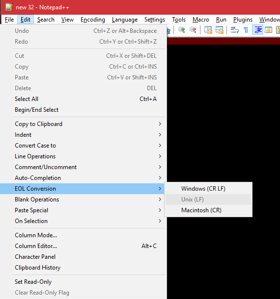

Three things come to mind. Do you have the MAP transformation service installed? If so, did you create the file in Windows and save it to a Linux OH server? It may have incorrect EOLs in it… run dos2unix on the file or copy a working MAP file and then paste the contents into it. It could be a permissions issue too.

If you’re using OH in Linux, then it is likely the EOL. Notepad++ has a setting for this, and you can set a default. You can just change the EOL for the file in Notepad++ and save the file to change it.
