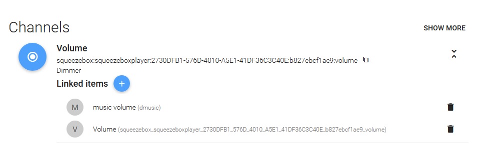

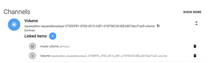

this is how it supposed to show in paper ui?
